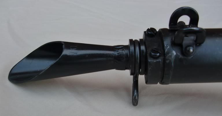

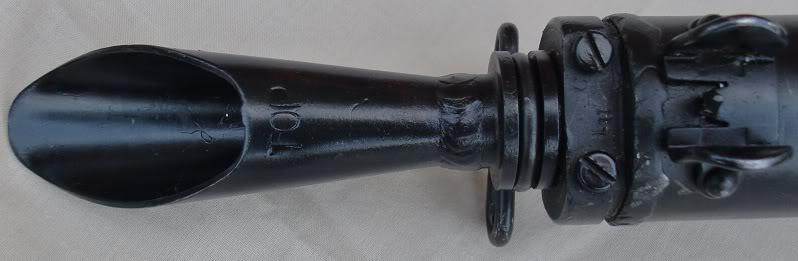

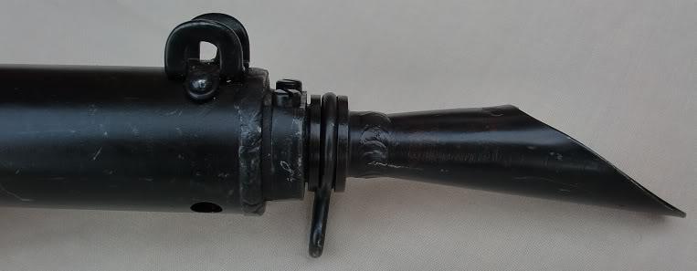

    Does any one on the forum own a STEN Mk1* or have a photo of the front muzzle end? I am making a Mk1* Barrel Bushing for my Mk1 but I can't find a photo of the front of the gun. The only part I cant figure out is if there is a 35/64" hole all the way through (On the Mk1 barrel bushing, the flash hider cone fits inside this hole reducing the diameter to approx 3/8") or if its just the section that abutts the barrel. Also need to know if the section that the cone is welded to is machined off as part of the Mk1* manufacturing process or just left as is.

    So many q's, so little time............ We have a couple of them. Why don't you come over and take one apart. It LOOKS as though the BUSHING, barrel, front is the same on the Mk1* except that the worthless spoon billed muzzle depressor has been left off or cut off and made good
    Next question.........

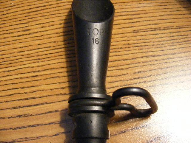

    I realize this is an older thread, but I thought perhaps a photo of my weekend gun show find would be of use to future sten enthusiasts. Not sure if it is real or a repro, because it is awful clean for a 70 year old artifact.

    It could well be original, the welding is tidier than on my own and the wording is in a different Type to mine too but all the copies I've seen are machined from solid whereas the originals are welded from sheet and have a weld down the inside of the cone. Does it have a weld seem down the inside top of the cone?

    It does have a seam along the inside beneath the word "TOP". Other markings include a 16 beneath the word TOP, and a tiny 9 below the sling swivel. The P in "TOP" is double struck, not unlike the T on yours. No sign of a broadarrow....should it have that mark?
    I didn't know there were repros of the mk1 cone.....must not have been a high selling item I should think. Mk1 stens are a pretty rare bird, at least in this country.
    The fellow I got it from at the show had no idea what it was for. Another vender told him it was a funnel for a loading press. I decided to risk the $15....even if it is a repro it is still something one does not find often.

    If its got the weld then I'd say it's original and for $15 its a steal! I forgot to mention I've not seen a repro with the word TOP on it either. There are quite a few repro STEN Mk1s in the UKicon and I looked at quite a few being sold as original before I found my original gun. I'm just glad I took the time to research them before the right one came along. I think Peter mentions in his book that trying to return a Mk1* to Mk1 proved difficult due to the cone flash eliminator being a rolled cone and I guess that is why the repro's are machined from solid (And show all the cutter marks too).
    Are you not tempted to build a replica Mk1? A Mk2 kit would provide about 80% of the parts and the rest is easy to fabricate/machine (Except the butt bracket as its a cast item).
