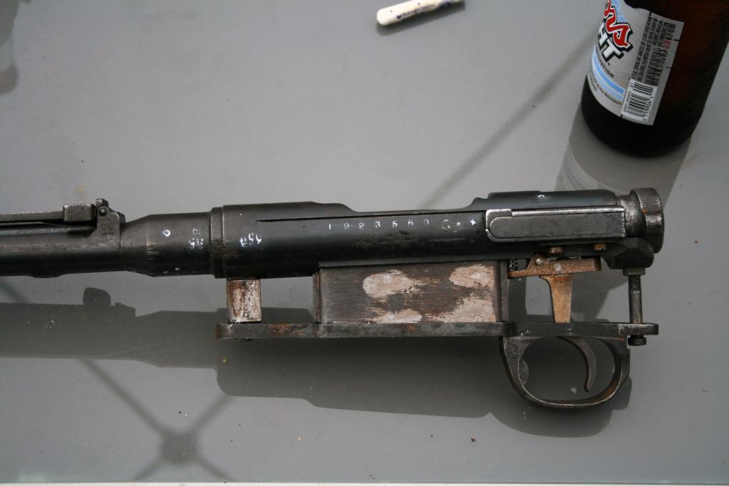

    I have what looks like a Type-38 Carbine. It has no Mum and no markings where the Mum should be. It was never there. The front sight has rectangular cutouts on either side. It's all matching and says "35" on everything. There is a Circle with a triangle on it on the rear of the receiver on the top (near where the bolt handle is). There is the same mark on the left side of the barrel just ahead of where it screws into the receiver. The stock is beat to hell, but the metal still has very good bluing and the bore is pretty good (and is rifled).
    There are serial numbers > 1923560 with three rings after it in a triangle (12 O'clock, 5 O'clock and 7 O'clock), then a small Japaneseicon character and after that what appears to be an "X". I'm assuming of course all the "35" markings on all the parts correspond to the "35" in the middle of the serial number.
    Any Idea what this thing is?

    I will be easier to tell what you have if you post some pictures of at least the left side and top of the receiver and one of the whole thing. Whatever it may be, rifle or carbine, with a 7 digit s/n it was most likely made by the Koishikawa (Tokyo) arsenal. Kokura has the same symbol but IIRC all of those were 5 digit s/n's.

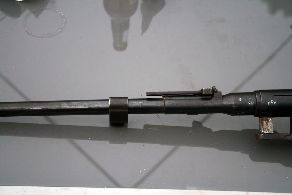

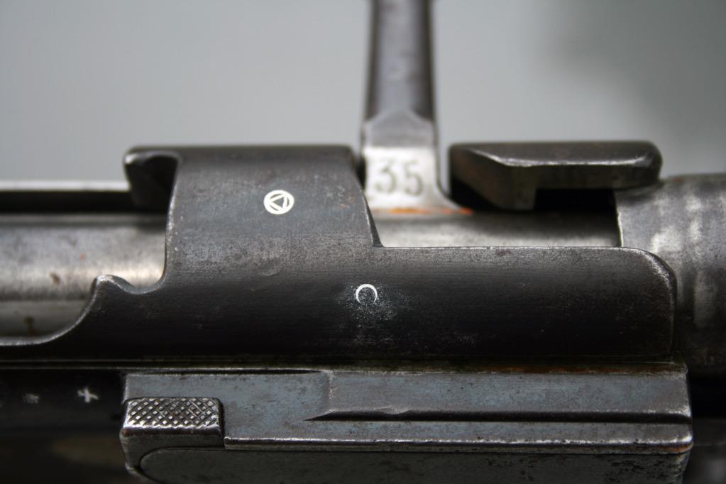

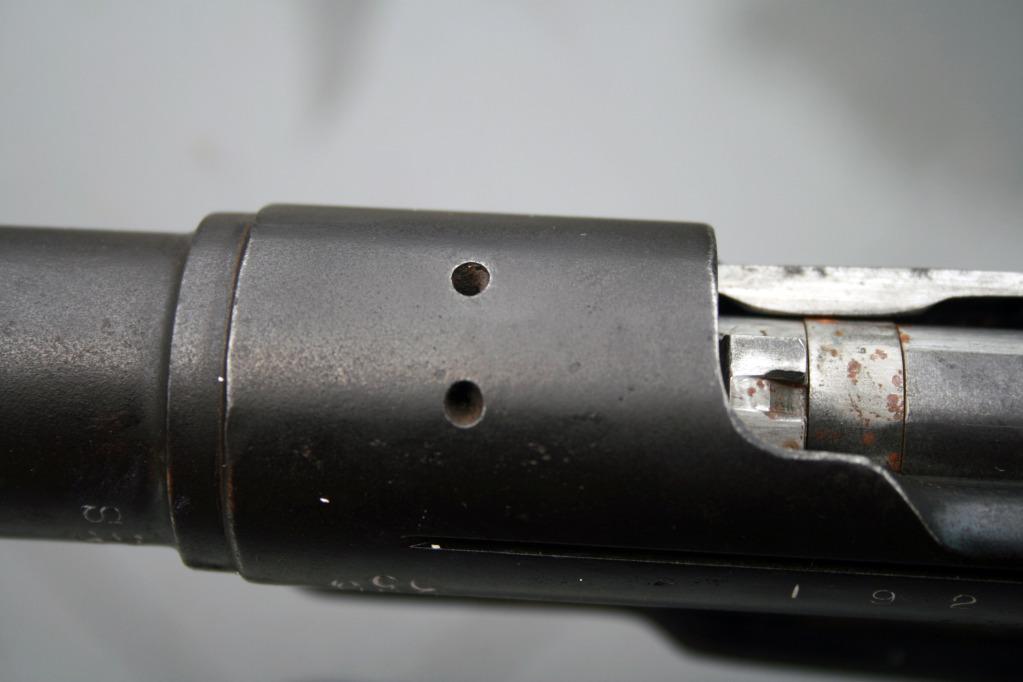

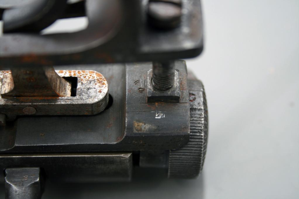

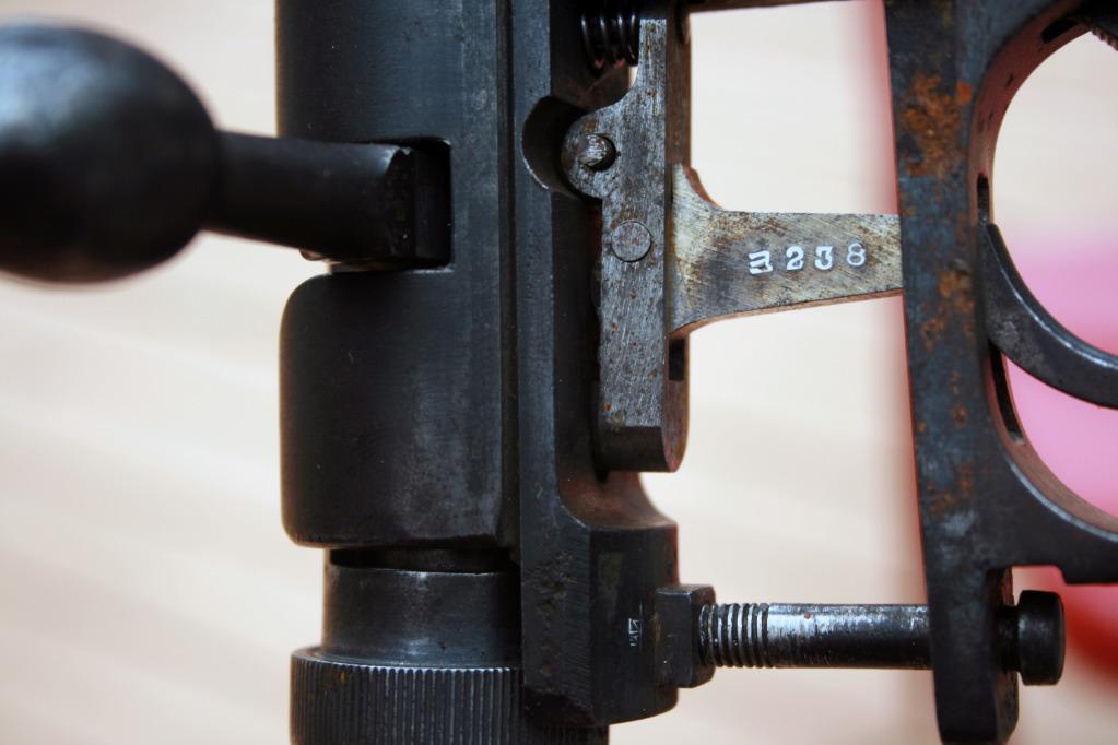

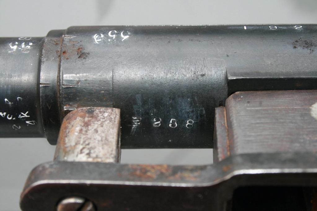

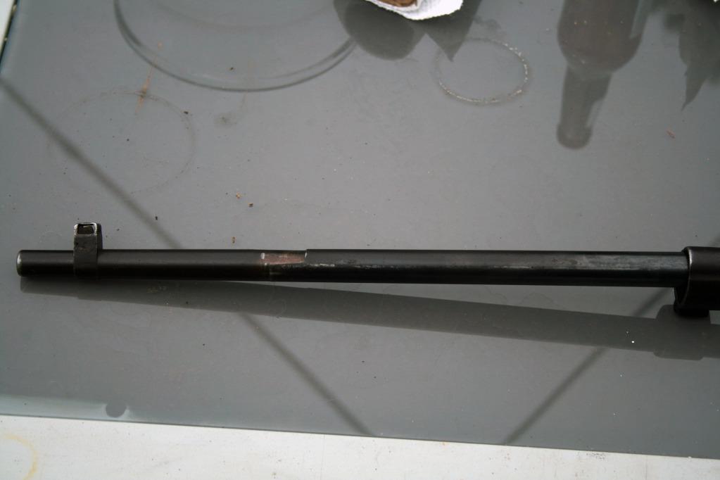

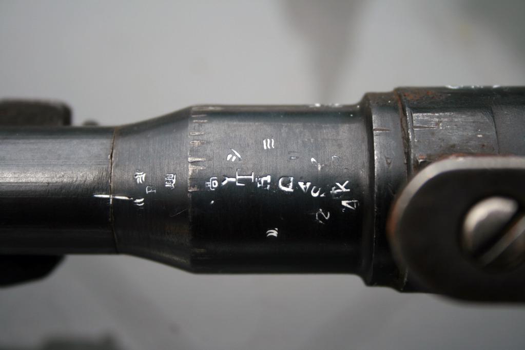

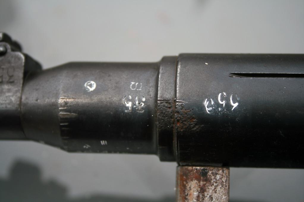

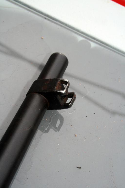

    Ok, here are the pics.

    From the looks of it your gun started out as a rifle made at the Koishikawa Arsenal around 1933 or so. It appears to have been cut down to carbine length at some point as the upper band and rear sight are from a rifle, or else judging by the wrench marks on the barrel it's a put together using rifle and carbine parts. To my knowledge all carbines made by Koishikawa Arsenal were 6 digit s/n's. The #238 on the trigger and the bottom of the receiver is an assembly number,don't know about the ''35''it does't seem to be of Japanese origin. There's a lot of markings on the knox form I've never seen on an Arisakaicon before, Russianicon maybe? Someone wot knows more than me will be alone shortly and shed some more light on them, just hang on.

    Well, I still have this rifle and I'm not sure exactly what to do with it yet. If it's a T38 carbine I'd try to find a carbine stock and restore it back to its as issued configuration. If it is a cut down rifle I'm not sure. Is there any way to tess for sure if it's a carbine or not?
