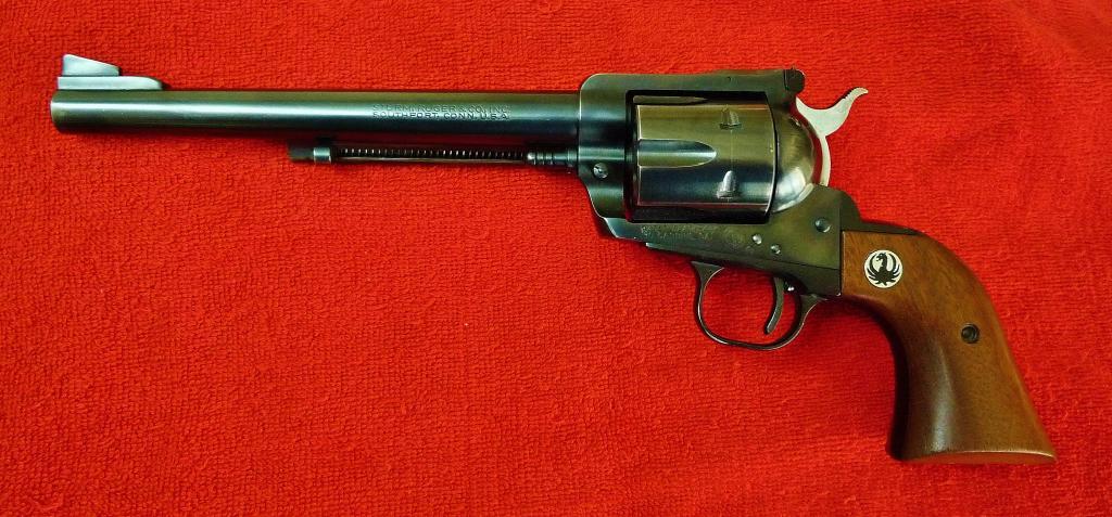

    You might look into modifying only the cylinder of an existing DA .30 cal. revolver, like a Nagant, but I doubt it could take the pressure of the .30 Carbine round. I wonder if it would be easier (or possible?) to convert a .30 Carbine Blackhawk to DA? But the best idea is probably to find a Blackhawk and be content with single-action. You can load or have loaded .30 Carbine designed for the revolver barrel length using a faster powder which results in less of a fireball.

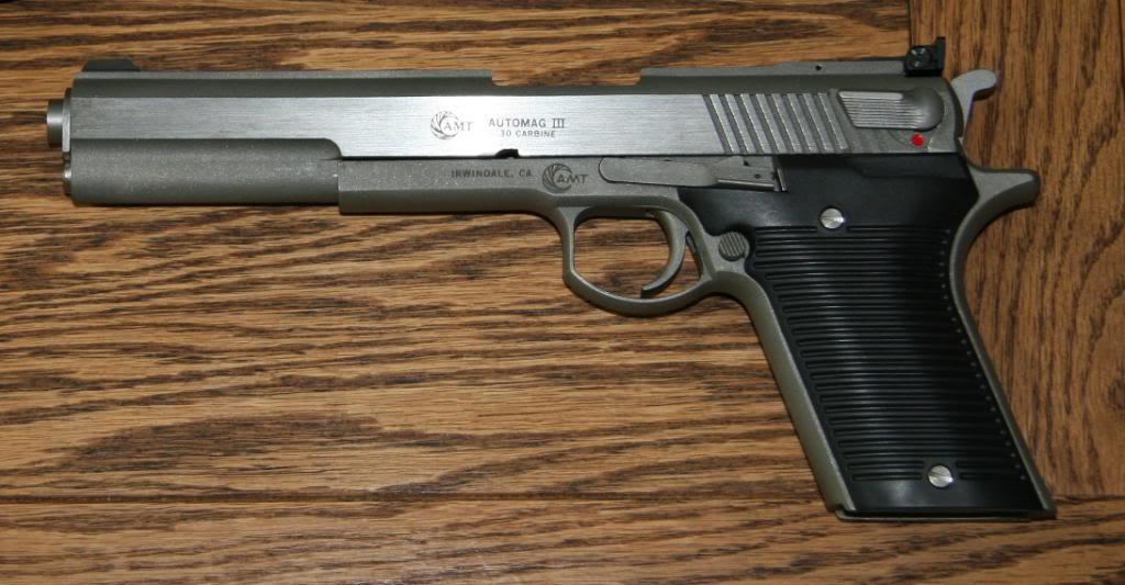

    Off the top of my head, I think it would be easier to buy a 30. carbine Ruger and redesign the action to DA. At least then you know the barrel and cylinder will work. And you will know the gun will not blow up on you. Or you can buy an Auto Mag III.
    Now my father "Big Bubba" is up for the work. $ 10,000 and two years and he can probably do it for you.

    I have the Ruger and AMT Automag. Fun to shoot, but a bit of a flash out the business end.

    This would be an interesting project just don't expect to end up with any sort of compact powerhouse. I can't speak for the Auto Mag but the ballistics from the 7.5'' Ruger royally suck, 1200fps/350 ft lb ME is about the best one can get with hand loads. That's no better than a 9mm Luger, unless modern propellants have changed things since I had mine.
    And one other thing the guys forgot to mention, in addition to having a helluva muzzle blast these things are really LOUD!
