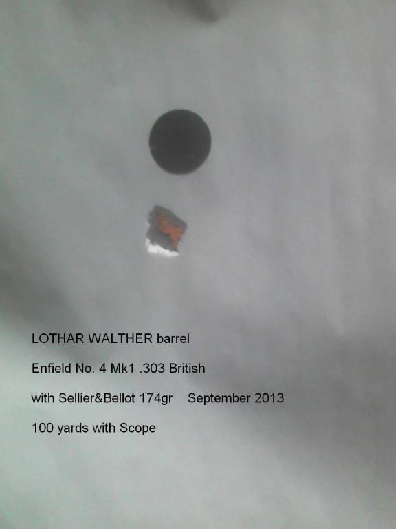

    Last year I was the happy recipient of four brand-new CNC-machined No. 4 Mk. 1 rifle barrels. These have delivered exceptional accuracy. We are currently attempting to find enough interested individuals to arrange another order, this time of the Heavy-Contour No. 1 Mk. 3 Lee Enfield Barrel. If anybody is interested, we are collecting names. Lothar Walther, a renowned barrel manufacturer will make a run based on an exact CNC copy of our barrel contour sample. We need a minimum of 20 barrels to have them do a run. Interested parties should contact Brett Barclay by email: canwesttriggers@sasktel.net. More information available at his website (Welcome to Lee-Enfield Rifles)

    Not bad at all. Pity the critical piece of info: how many rounds in the group, is not provided.
