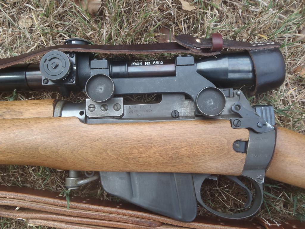

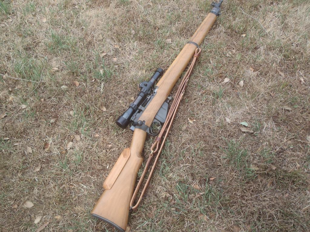

    Hi All, My first post here but I have been a longtime "lurker". I purchased a very sad No4 last year, I was told at the time the barrel was OK but on closer examination the barrel was pretty bad.
    Obviously a steady diet of corosive ammo combined with years of neglect. I wanted a shooter and decided to go the No 4T replica route. I spent the latter part of last year gathering the parts as well as a new stock from the UKicon. There is still some fitting issues to sort out wit the fore end especially the front wood and the required pressue with the barrel.
    Pads have been fitted by another forum member and we (my brother and I) fitted a used but excellent condition barrel. Please note there are still a number of issues to sort out and the final refinishing of the metal which will take place soon.
    This wont be passed as a legitimate "sniper" rather a faithfull restoration / saving what was effectivley something unusable.
    Can I say thank you to all of those members here that contribute a massive amount of knowledge, to Peter Laidlericon and the gems he has posted here as well as the other members who have some very helpful information.
    All of the parts with the exception of the pads are Longbranch, I have fired this rifle but achieved nothing near what it is capable of yet, please feel free to pass comments any feedback is appreciated.

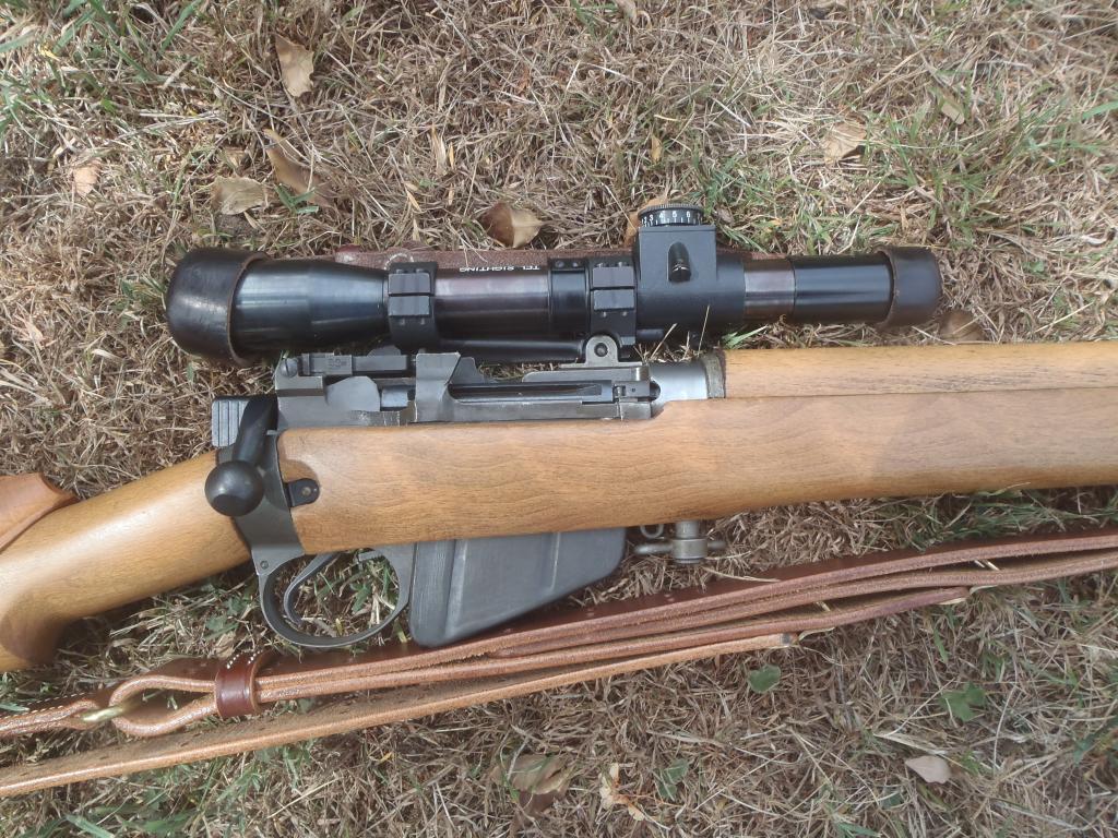

    Nice blond wood hope you sort the issues out, one thing I noticed is the pin is missing from the rear sight axis pin they come up on flea bay at times usually on the UKicon market I may have a spare one some where I can give you if you have no luck.
    You may wish to stake the screws on the pads if your going for the authentic look but it is up to you if they were fitted as per Peters threads they should never move but Peter L may comment on this as I think when they were fitted they slotted the screws and ran solder down whilst heating the area then did them up sequentially.
    As the area cooled down it shrank and pulled the screws even tighter, if you get the book an Armourers perspective Peter wrote it is a wealth of information on the T's and a worthy addition to your collection they can be had from Ian Skennertonicon in Aus I picked up a signed copy from him last year.
    Is that a repro 32 scope if it is how much did it set you back as I am thinking of doing a replica T so I do not have to use an original I have a spare No.4 rifle but not the other gear like the pads, bracket and scope I have a butt stock with a cheek piece fitted already just toying with the idea and trying to sneak the upgrade in under the radar.

    Thanks for the comments Cinders, noticed your from WA and headed there soon for work. We have an office in Canning Vale I visit from time to time. I have the pin for the rear sight just havent fitted it yet. Was waiting for the visit to the blueing tank before full re assembly. Thank you for the offer though, much appreciated.
    I have a proper front swivel and am waiting for the machining to be done as per Peters thread.
    The front nosecap gave me no end of trouble and I couldnt fit the front band.
    It was about this time I popped out the pins and noticed the location was a little "off". About 2 - 3 hours work fixed that although I need to fill the existing holes and re drill them on a milling machine so we dont follow the original holes.
    Yes the scope is a repro alas it isnt mine yet, I borrowed it from my brother as he was lucky enough to find a geniune item for his BSA No 4 T.
    This scope has some issues and needs some work to overcome problems with the elevation drum, said drum has some play up and down, a friend dis assembled his and made some adjustments. The very slight movement during recoill shifts the stadia up and down making accurate shooting impossible.
    There is nothing wrong with the clarity of the optics though and my friend is fielding his replica on an L42A1 replica with no issues after 100's of rounds downrange.
