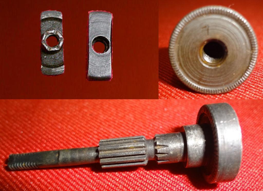

    100% WRA Lockbar Rear Sights..

    Trigger
    Rear Sight
    Single Slot Gas Plug

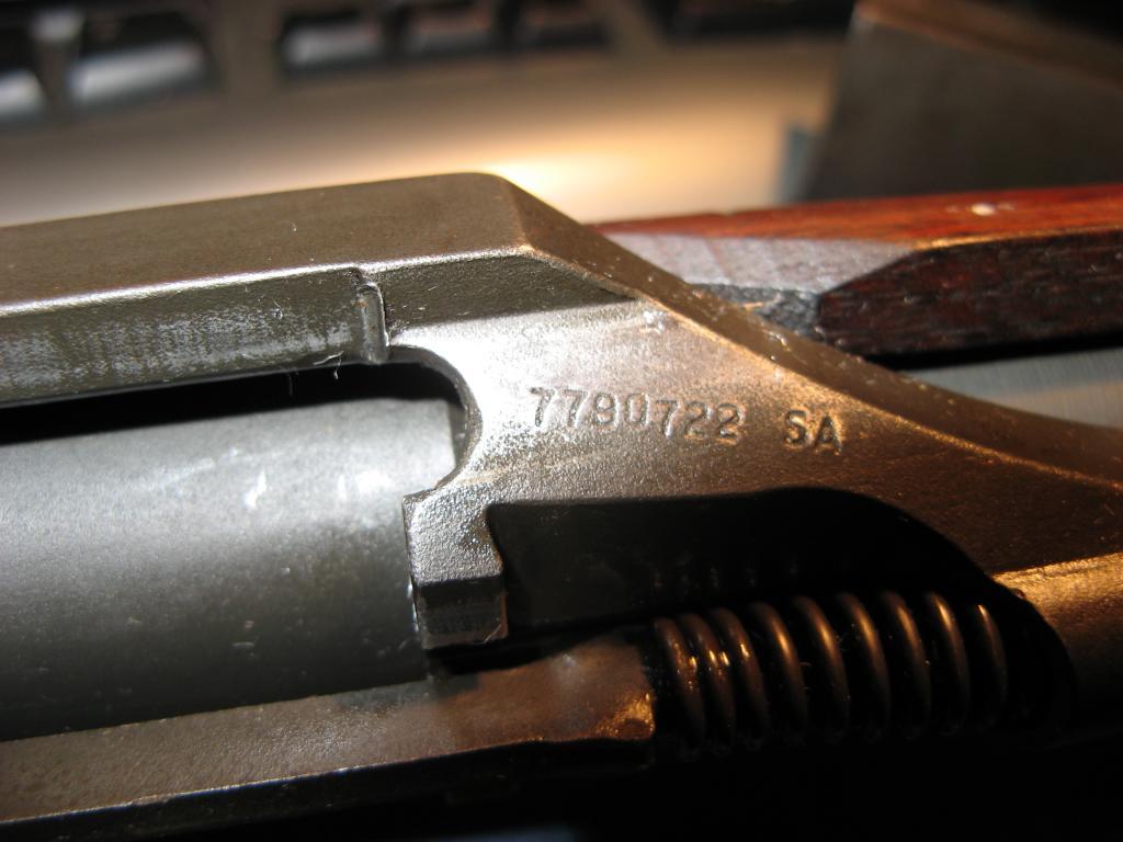

    Am I seeing an SA electropenciled on the receiver leg? That would say it was rebuilt at Springfield. Either it was done twice, or the stock is off a Rock Island rebuild.
    I believe it was done at Springfield in 1964 (pencil marking), I believe you are correct on that the stock is off an RAI rebuild. that makes a lot more sense now that you pointed that out.
