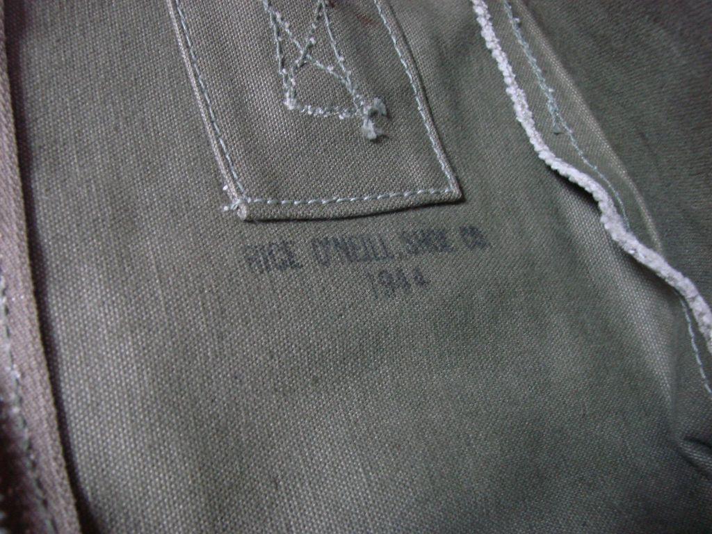

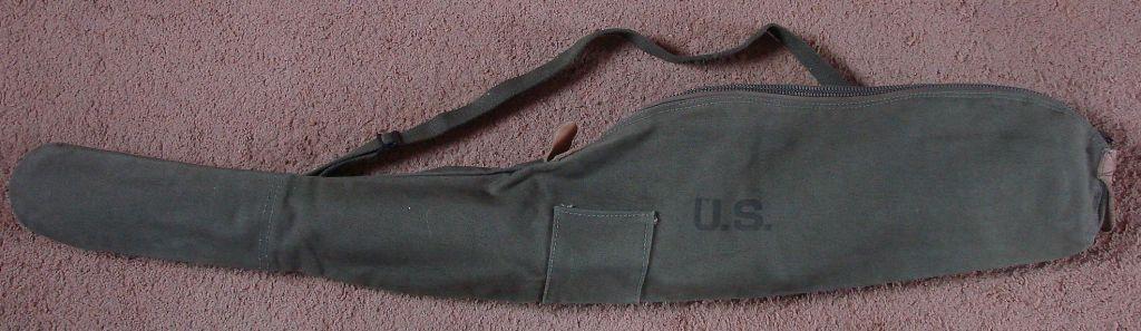

    Does this M1 carbine carrying case look correct- Rice O’Neil Shoe Co. 1944 marked?

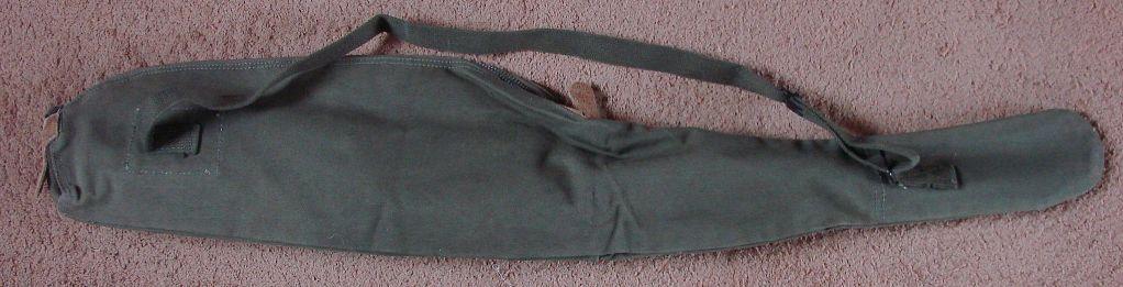

    I have been trying to find a list of manufacturers of these canvas M1icon carbine carrying cases with no luck.
    I got this case 10 years ago and I am wondering if it is original and correct.
    What are they worth today?
    Thanks,
    David

    These are the names and years in my collection. There are more then one of some names with the same year. But different color canvas, size of type, zipper color, or leather tab colors.
    And I'm sure there were more then I have.
    Year Manufacturer
    1943 CHATTA. AWN. & W.S. CO.
    1943 HAV. STCH. CO.
    1943 FORREST A. HEATH CO. INC.
    1943 J.A. SHOE
    1943 RICE O’NEILL SHOE CO.
    1943 TWEEDIES
    1944 AMERICAN TENT & AWNING CO. KNOXVILLE TENNESSEE
    1944 ATLAS AWNING
    1944 R.B. HANSON Mfg Co
    1944 M.-D. MFG. CO.
    1944 RICE O’NEILL SHOE CO.
    1944 SHANE MFG. CO.
    1944 SMITH MFG. CO.
    1945 GOSS CANVAS PRODUCTS
    1945 M.-D. MFG. CO.
    1945 SHANE MFG. CO.

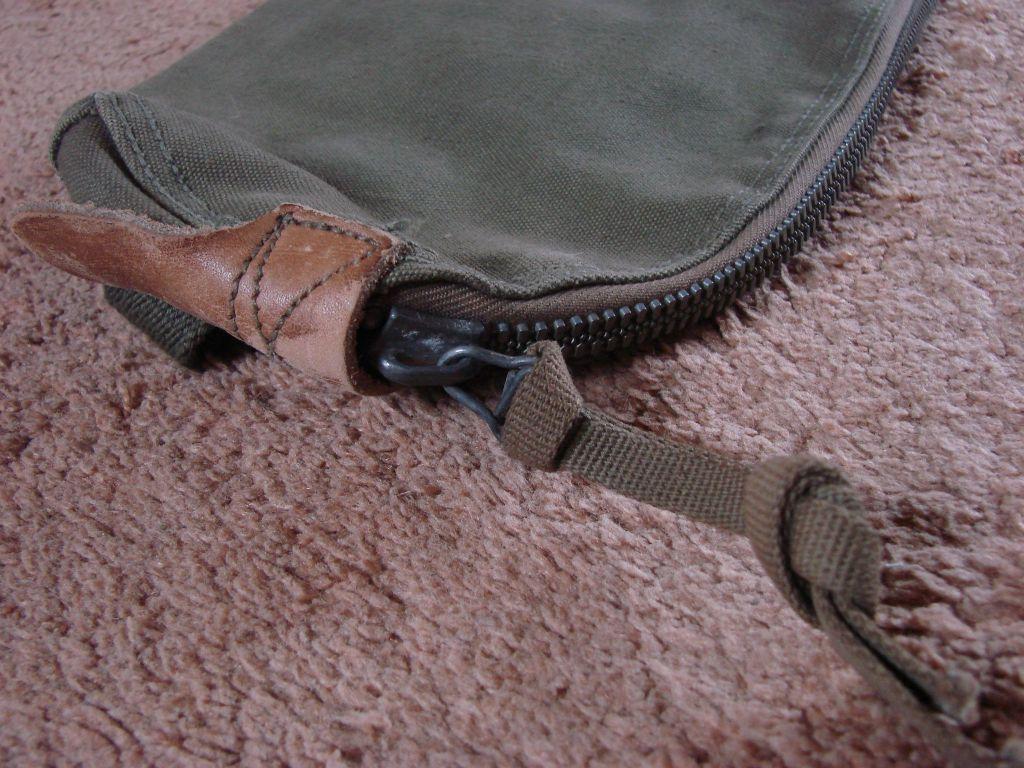

    The original one I have is marked 1944 R.B. HANSON Mfg Co and has a silver/gray Talon Zipper

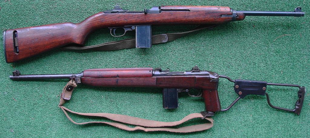

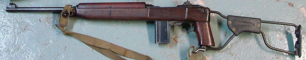

    I bought the M1 carrying case back in 2002 for the M1 carbine shown below.

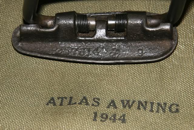

    I currently only have three. Two Atlas Awning and one Harian.
    These are the M1A1 Scabbards I have had over the years. Alway looking for different ones to add to my list.
    ALTEX PRODUCTS INC.
    1943
    ATLAS AWNING
    1943
    ATLAS AWNING
    1944
    CARTER BROS INC.
    1944
    HARIAN
    44
    HAV. STCH. CO.
    1944

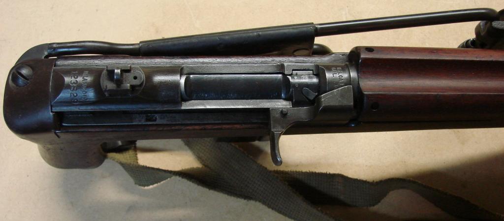

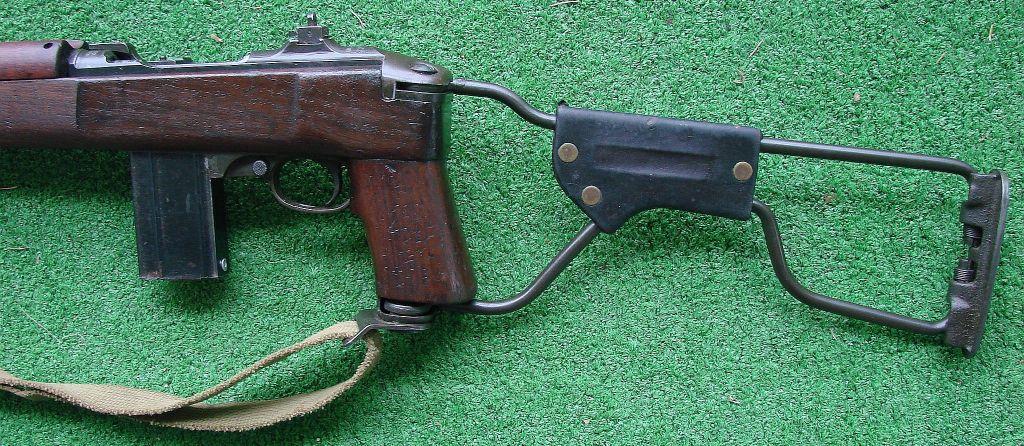

    Back in 2008 I purchased this M1A1 carbine in Canadaicon, 12-42 barrel dated, Sn. 123829.
    I believe it is in its original configuration, so that is what has got me thinking about the jump scabbard.
    I like accessories....but I have been away from the hunt for a while.
    David

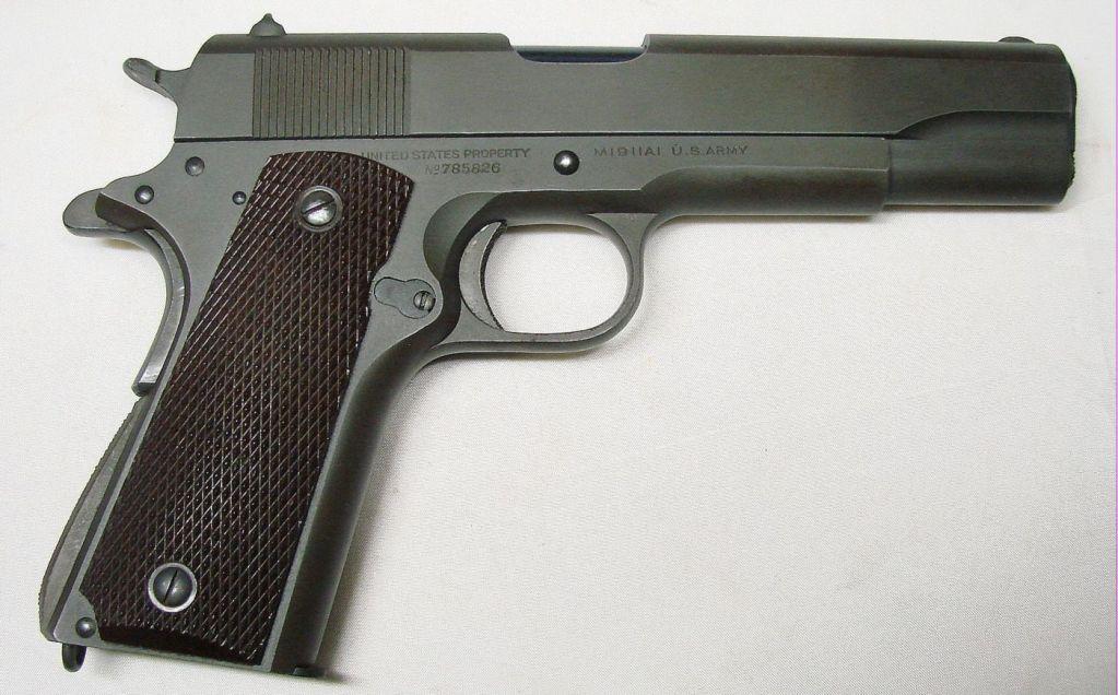

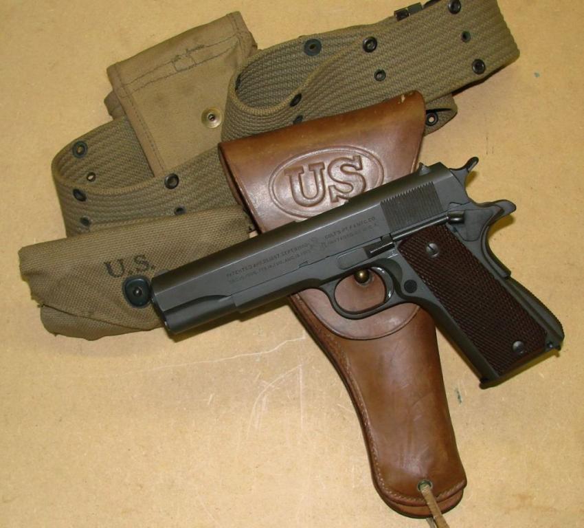

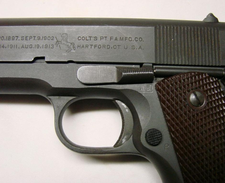

    A companion to the M1A1 carbine also manufactured in 1942- Colt M1911A1 rig.
    A period photo.

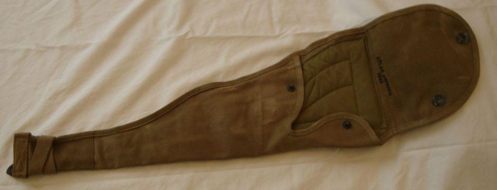

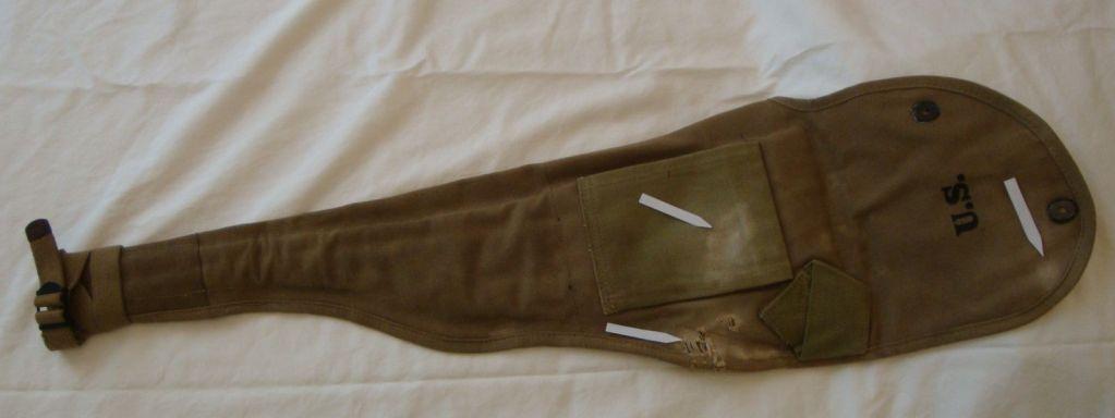

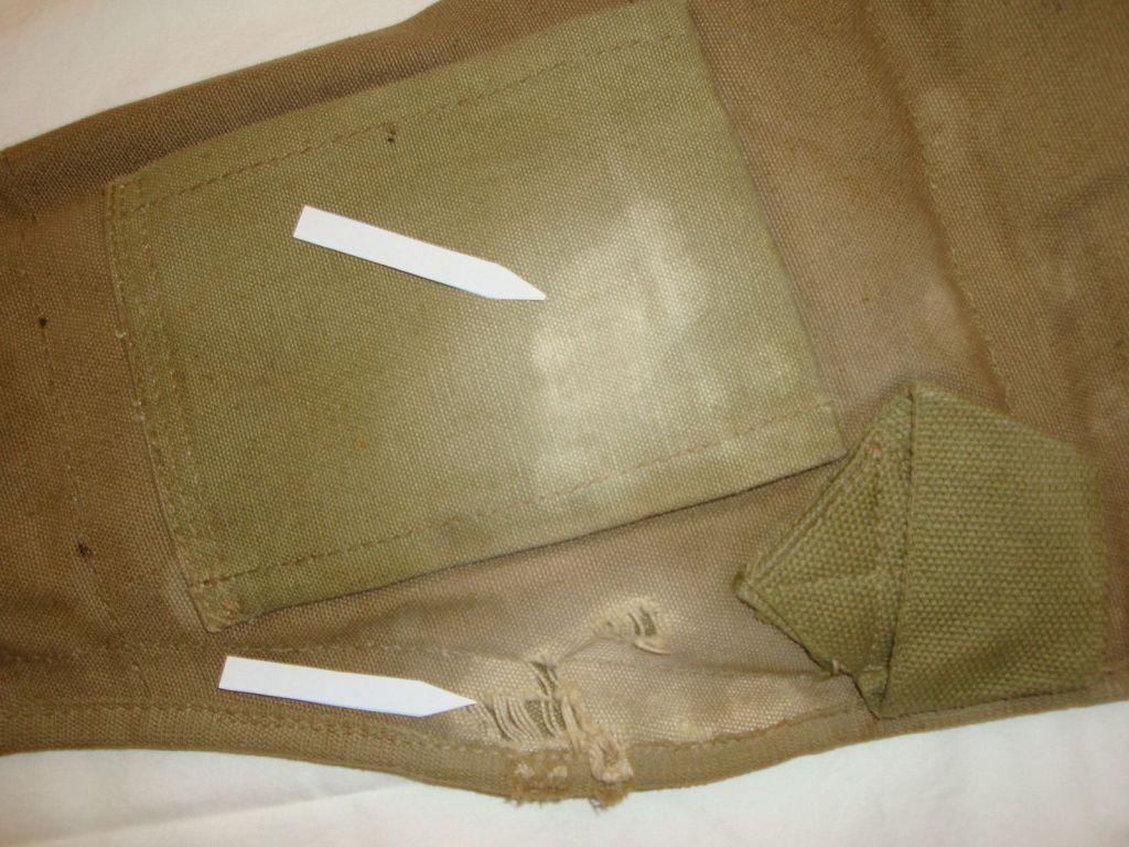

    This is the M1A1icon jump case that is being offered on eBay today.
    Starting bid $199.
    IN NICE CONDITION, GUARANTEED TO BE ORIGINAL AND GENUINE, WE HAVE A 1943 ATLAS AWNING LIGHT KHAKI M1A1 PARATROOPER FOLDING CARBINE JUMP CASE. THESE ARE IMPOSSIBLE TO FIND AND THIS IS EXTREMELY DESIRABLE AS IT WAS A USED JUMP CASE. THE CASE HAS A WORN THROUGH SPOT EXPOSING THE CLOTH FIBER THREADS AS SEEN IN THE PHOTOS FROM ACTUAL USE ON THE MOUNT SIDE OF THE CASE AND NOT VISIBLE WHEN WORN. THERE ARE TWO WHITE SPOTS ON THE HOLSTER IDENTIFIED IN PIC'S WHERE SOME IDIOT (me) ATTEMPTED TO REMOVE A DEEP OIL STAIN WITH K2 SPOT REMOVER. IT IS VERY POSSIBLE THAT THESE SPOTS MAY BE REMOVED BY SENDING TO A DRY CLEANER. DON'T LAUGH I HAVE SENT GREASY U.S. WEB PISTOL BELTS THAT TURNED OUT AMAZING SHOWING NO WEAR AFTER THE CLEANING PROCESS. CASE HAS "KLIK IT" SNAPS AS SEEN IN PHOTOS. I HAVE SEEN MINT CONDITION UNISSUED CASES SELL FOR $750.00. THIS CASE IS PRICED TO SELL!

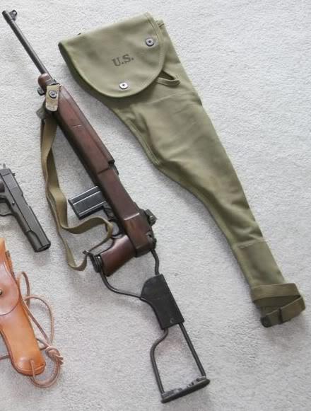

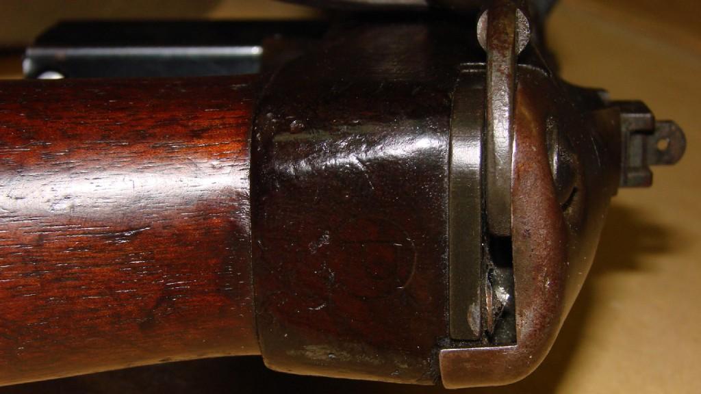

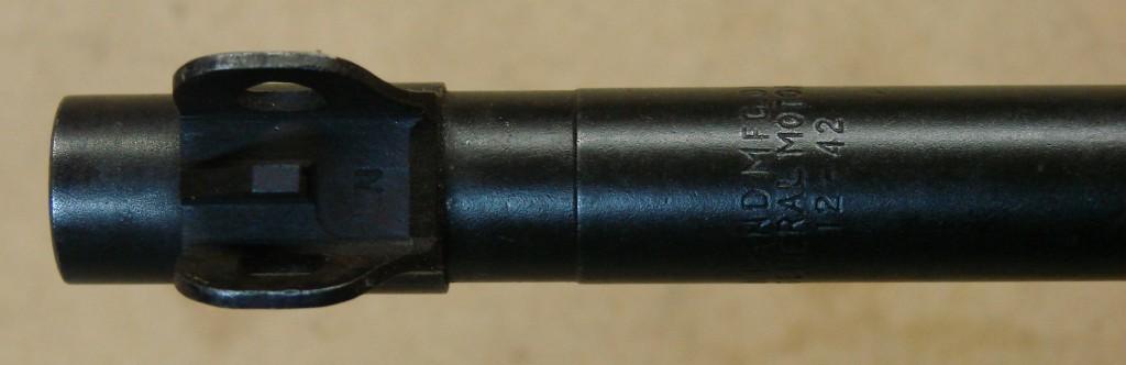

    The principal markings on the exterior of this 12-42 barrel dated M1A1icon carbine.
    Supposedly the M1A1 carbines only started to get distributed in 10-42.
    David
