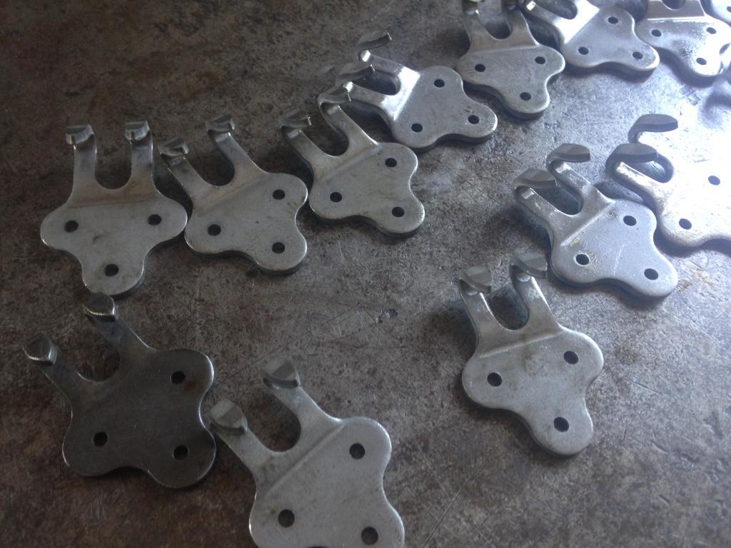

    Video: M1907 Sling Hook Blanking and Forming Dies/Test Run
    Here is a short video showing the operation and test run of the M1907 Sling Hook Blanking Die.
    Here is a short video showing the operation and test run of the M1907 Sling Hook Forming Die.
    Finished product in the white.
    [/URL][/IMG]
    Next off to the tumbler, tumbled with corn cob and ceramic media to deburr (may have to use hardened steel shot), then to the Parkerizing tank. My tumbling and Parkerizing set-up is very simple. I use an old steel 4 cubic ft. cement mixer and a U.S. Surplus M59 Field Range with custom stainless tanks for the park solution and hot water rinse. This way I don't have to have a dedicated permanent set up, and yes, I do it all outdoors under a welding shed by the barn, especially when using the M59. My plan is to convert the M59 Burner Unit to Propane or Natural Gas. Found some good instructions on the net for the conversion.
