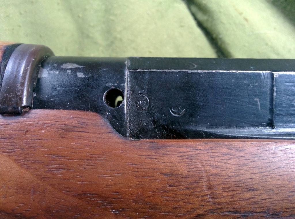

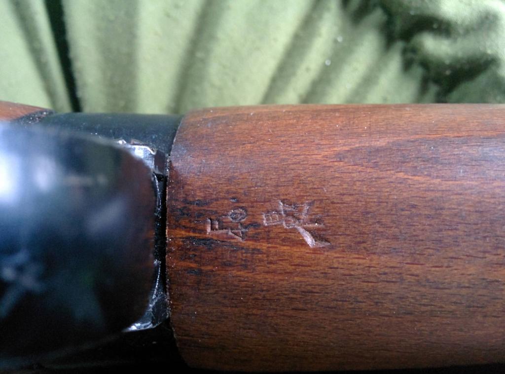

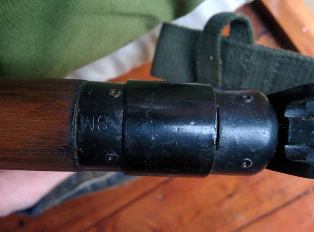

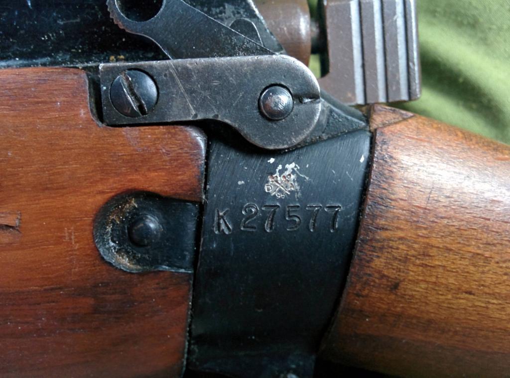

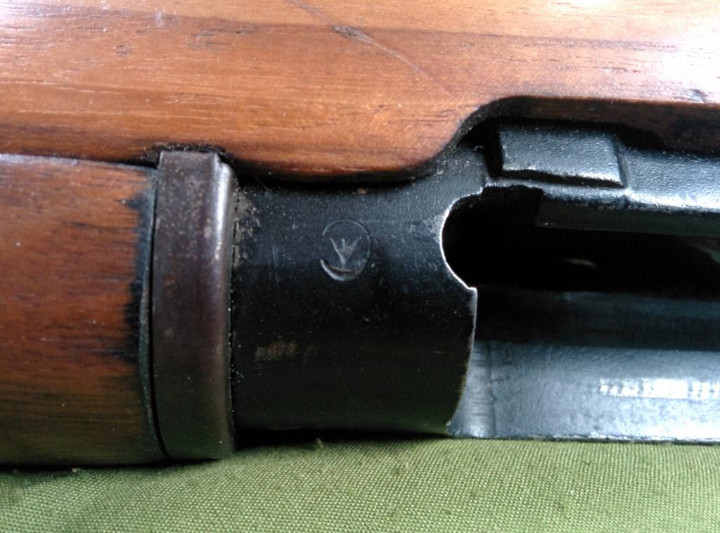

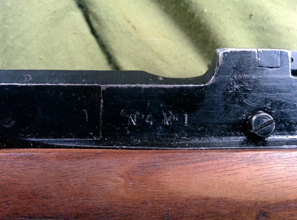

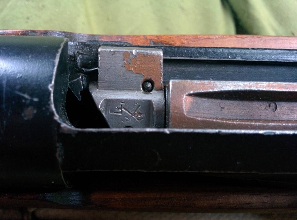

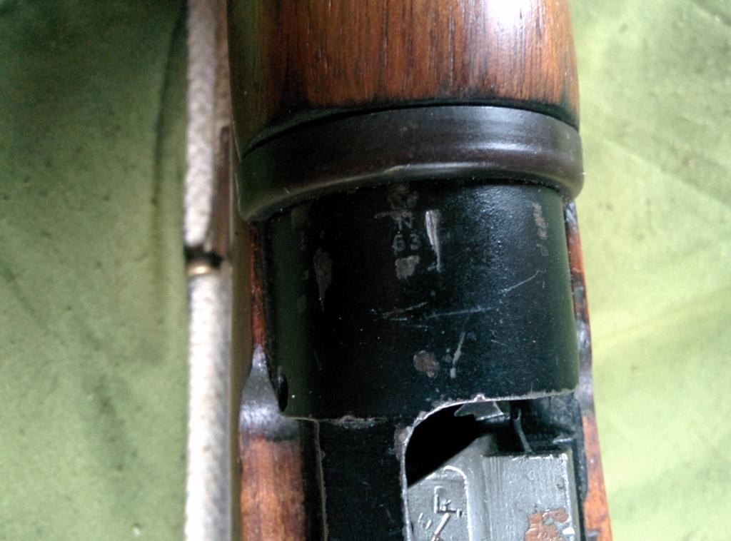

    Just acquired a No.4 Mk1 deac from a dealer here in the UKicon (for my father, actually). The dealer advertised the rifle as being made in 1942 at the Fazakerley factory and being all original except the bolt. Also, he stated the woodwork was beech, but later said it might be ash. On receiving the rifle, there is no date stamp. I contacted the dealer asking him how he established it was a 1942 and he said he got it from the serial number, but he hasn't responded to me asking him how he did this. So, what can you experts out there tell me from the pics I took below...

    It has a Canadianicon Army ownership mark and a mix of wartime and post war woodwork from what I can see in your pics.

    It's a total mix and match with a copper plated ex DP bolt to match.

    Those round inspection markings indicate to me that your rifle started life as a Maltby No4MkI

    As others have said, I see a mix of markings.

    If I'm to complain to the dealer, I need specifics. It would be much appreciated if you guys could point out specific markings that indicate the gun is not as described. Also, is there any way the dealer could claim the gun was manufactured in 1942 as he claimed?

    As per the OP's original question, and as per Ian D. Skennertonicon,-
    "No.4 and No.5 rifle serial numbers can readily identify manufacturers. Britishicon No.4 rifles have five numbers, usually after one or two letter prefixes. The same letter prefix(es) were used by Maltby, Fazakerley & BSA Shirley, A to Z then AA, AB to AZ, then BA to BZ, CA to CZ &c. Maltby rifle serial numbers commence with a number '1', Fazakerley with a '2' and Shirley with a '3', e.g. 1xxxx for Maltby, 2xxxx for Fazakerley and for Shirley, 3xxxx, after the letter prefix. Late Shirley numbers then supposedly ran A4000 to A7999 and with PS prefixes at the very end of production. Post-war Fazakerley No.4 rifles had PF letter prefixes."
    So going by your your rifle's serial number it was made by Fazakerley and 1942 sounds about right. The rifle was then at some point put through a post war rebuild which explains the Suncote finish and as was common, the use of serviceable mixed parts from stock to complete the rebuild without thought of making it all matching for later civilian collectors of these rifles, just like Garands were.
    It also saw service as was previously noted with the Canadianicon military. It should be a good collector piece and I would not be too worried about the mix of parts as it shows that it had a useful life which is why it required a rebuild and also most certain war use.

    As Lee Enfield says, the circular markings are Maltby although I have seen similar marks on Maltby refurb of a BSA rifle. Maybe some additional photos of any marks on the back action flats or barrel (under the woodwork) might help with a definitive origin.

    The serial number is a new one in my opinion, it would appear the wrist has been scrubbed and a new number added.
