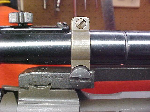

    Well, maybe someone can explain this:
    The windage screws on this Redfield base came directly to me from CMPicon, & they are clearly parkerized. So, did the War Dept order parked screws from Redfield, or did they park case hardened or blued screws? I don't know the answer, hoping someone else does.
    Neal
