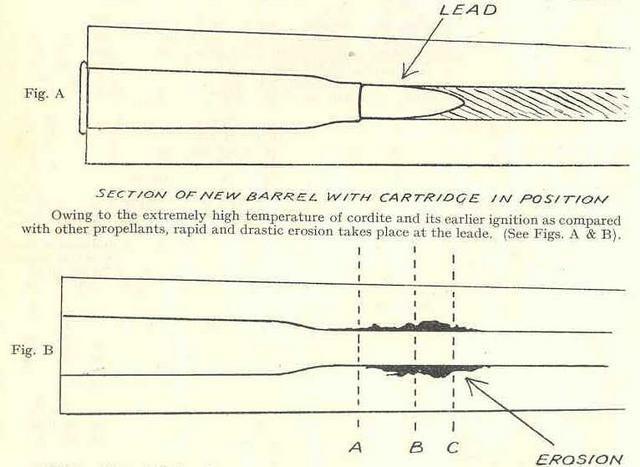

    (b) A new barrel from the factory may always shoot badly. During manufacture a barrel may be found which, after boring, is not straight. It will be straightened in a machine, or by a highly skilled operator. It is almost unbelievable, but a barrel so straightened will, as it heats up during firing, tend to reassert itself into the shape in which it was first finished, somewhat analogous to tied-down twig, always trying to regain its natural shape. Proof of this can be obtained by firing grouping tests in special revolving rest. No manufacturer's marks appear on such a barrel indicating it has been straightened. It is just a bad bargain and the only remedy is to scrap and replace it.
    (c) Bad shooting of a barrel after considerable use when the bore still appears to be in good condition may be due to leade (leed) wear, which is not easily observable or rarely looked for.
    Owing to the extremely high temperature of cordite and its earlier ignition as compared with other propellants, rapid and drastic erosion takes place at the leade. (See Figs. A & B).
    This erosion will bring about bad set-up of bullets with the consequent loss of velocity and bad accuracy, thereby affecting the size of the group on the target. The unit armourer tests for wear at the leade with a leade gauge at about point 'A'. He has no means of discovering erosion forward of the leade unless it is so bad as to be visible. If the amount is insufficient for rejection the barrel remains in the service; quite likely it will still group on the military target and is therefore serviceable according to military requirements.
    In order to ascertain whether the amount of erosion at points 'B' and 'C' is still insufficient to affect grouping powers, the combined gauging method must be adopted. This is attained by the use of two plugs, a method familiar to most civilian armourers.
    There is no cure under present conditions; barrels are made of a carbon manganese steel and are subject to this rapid erosion at the high temperatures developed by burning cordite. Germanyicon did and U.S.iconA. still do make high class barrels of chromium molybdenum steel to order, for individual customers; they are extremely costly and if obtainable in this Country would doubtless not be permitted by the N.R.A. for open Service Rifle competitions. Such fine barrels when used with the nitro-cellulose powder, which burns at a considerably lower temperature than cordite, will obviate the excessive leade erosion occurring with our equipment.
    Shooters who are bothered by loose groups with an otherwise good rifle, using good ammunition are strongly recommended to have their guns "combined gauged", it being presumed, of course, that all possible external faults, bad holding, bad let-off, etc., have first been eliminated.
