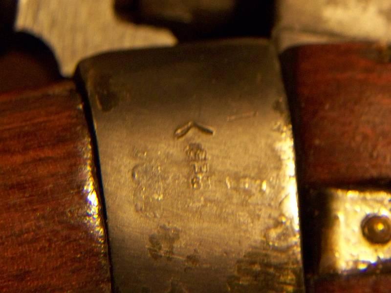

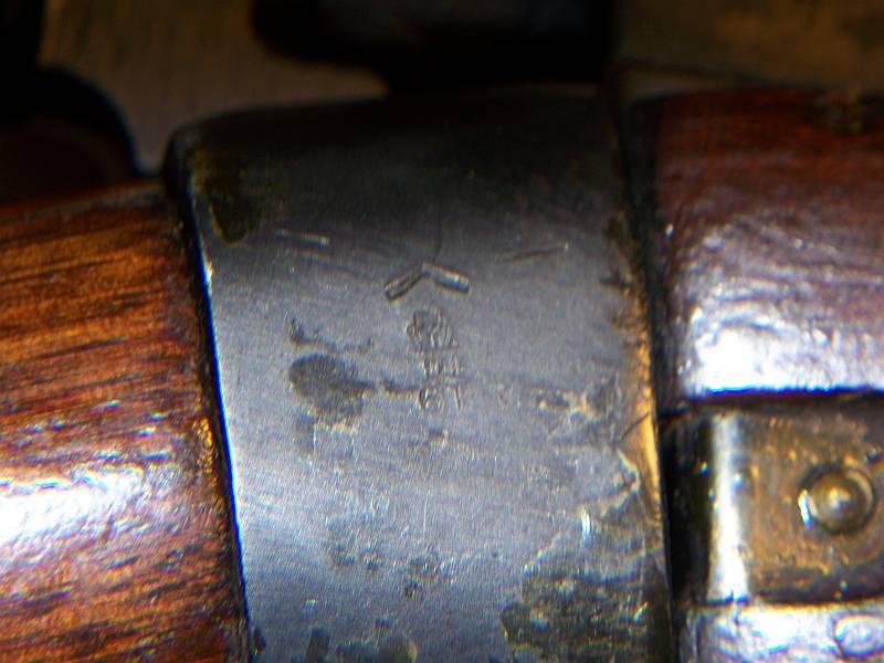

    On the right side of the wrist(?) under bolt handle there's this stamp: chevron over crown over an E on it's back over 6T

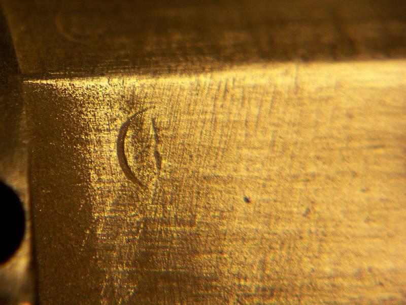

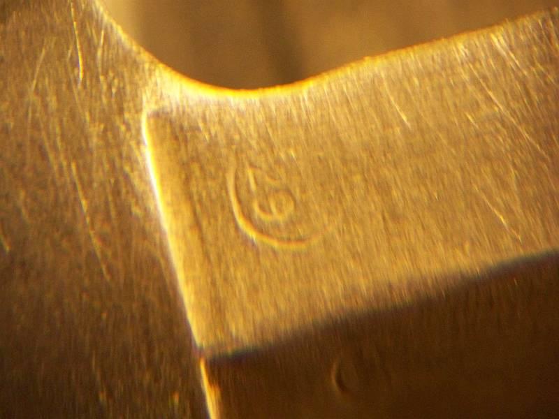

    Those are stamps. The upper left one looks like a circle with a B over 10. The lower right one I can make out a 2. Just above the B over 10 on the bit of angle is another circle with a 28 or 29 in it, can't see a letter over the number but there's a space for one.
    I see no signs of plugged holes. Looking very close with bright lights and magnifying glass.

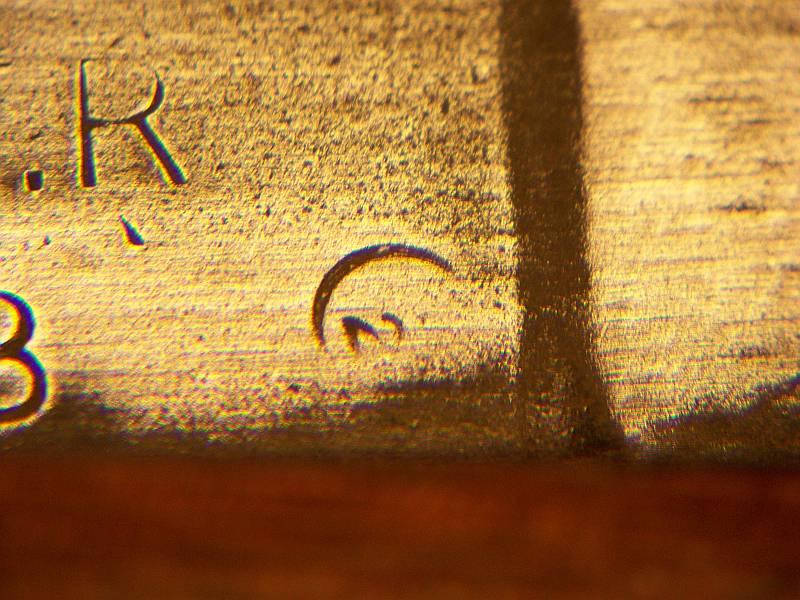

    And I keep telling ya, those ain't plugged holes. They are some kind of acceptance stamp, and there are three of 'em. They look like they were on there before the FTR.
    I can see how they might look like a stud ground flush with the receiver so here are some real close ups.
    Scotch Brite helps too!
    Clearly a 2 but can't make out rest.
    'B' over the number 10.
    29
