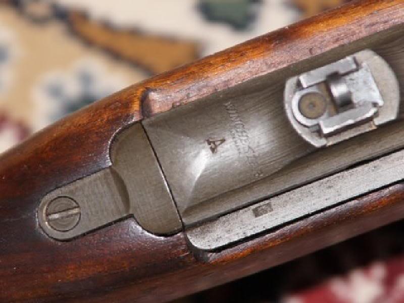

    "Presentation" implies that a gun was given away. During/after WW2, a number of M1icon carbines were given away by the manufacturers; these never had contract production serial numbers:
    Once this Ithaca was delivered to the US government, it would have been illegal for anyone in the US government to give it away. It was US PROPERTY.
    Neal
