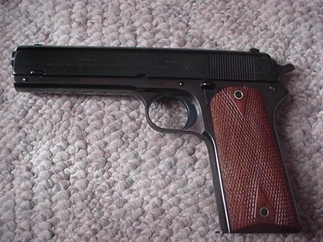

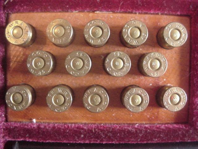

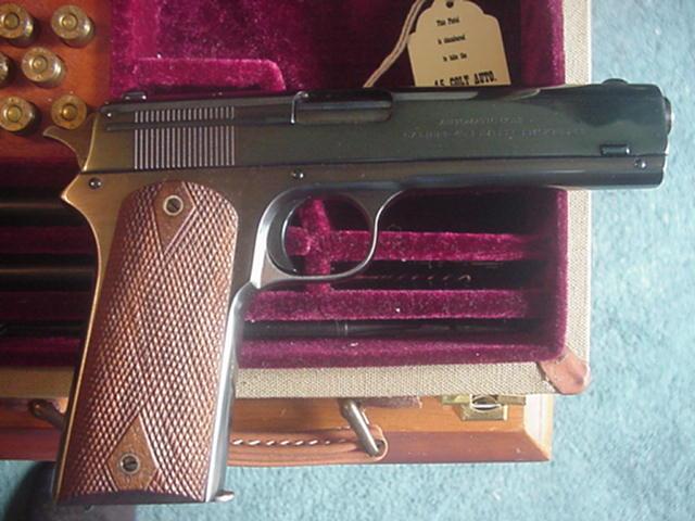

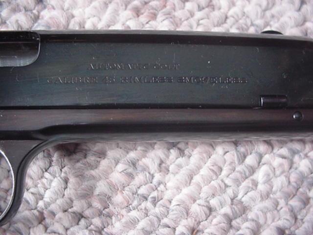

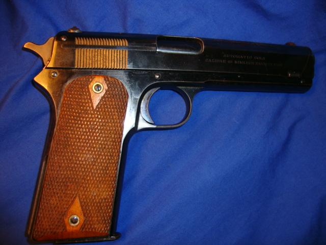

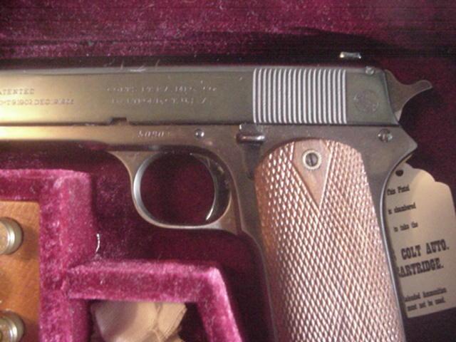

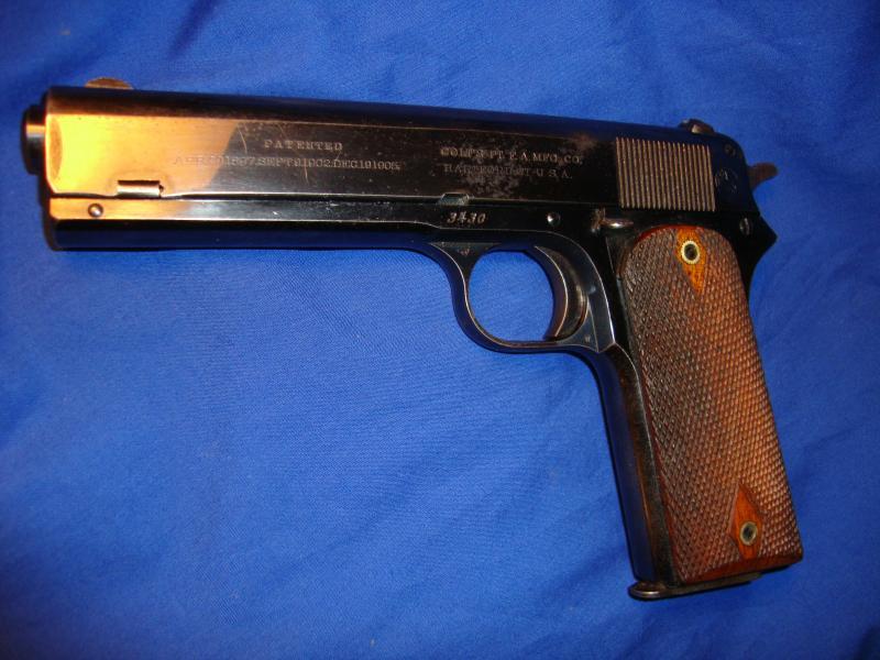

    Here's a link to Colt 1905 Military Model .45ACP listed by Numrich which shows ejector part 23 listed for $21.05 but is currently out of stock. Perhaps email them to let you know when it's back in stock. [url="http://www.gunpartscorp.com/Manufacturers/Colt-33188/AutoPistols-35748/190545AutoMilitary-34898.htm?page=2"]1905 45 AUTO MILITARY Accessories | Numrich Gun Parts[/url. Here are photos of my Colt Military Model 1905 .45 ACP pistol serial number 5090 (made 1910) which was shipped to Praeger Hardware Co. San Antonio TX on March 27, 1911 and sold to H. N. Moore Co. listed in the 1910 and 1912 San Antonio City Directory as a Sporting Goods Store on 326 West Commerce Street. The ammo is Winchester circa 1914 200-grain .45ACP which was adapted to this pistol.

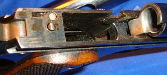

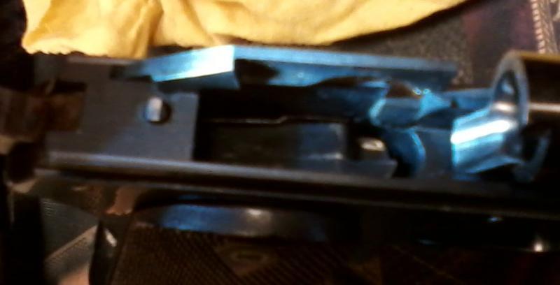

    Let's try some photos:

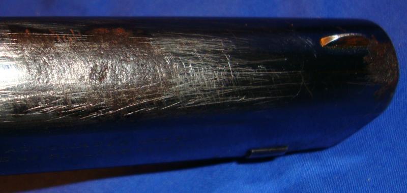

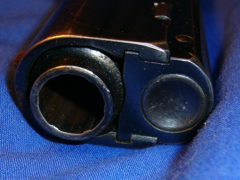

    The bad: No ejector, except for sheared off formerly integral retaining pin.
    Ramped barrel! But note the small cutout behind the sheared off ejector retaining pin. That's all that keeps the works in line, and the ejector runs all the way forward to the end of the barrel...
    Dunno if barrel impact or what broke the ejector, but it surely impacted. Not ideal, nor the norm with the earlier .38 Autos.
    The ugly. Don't mind the rust so much as the scratches! Errrrr!!!

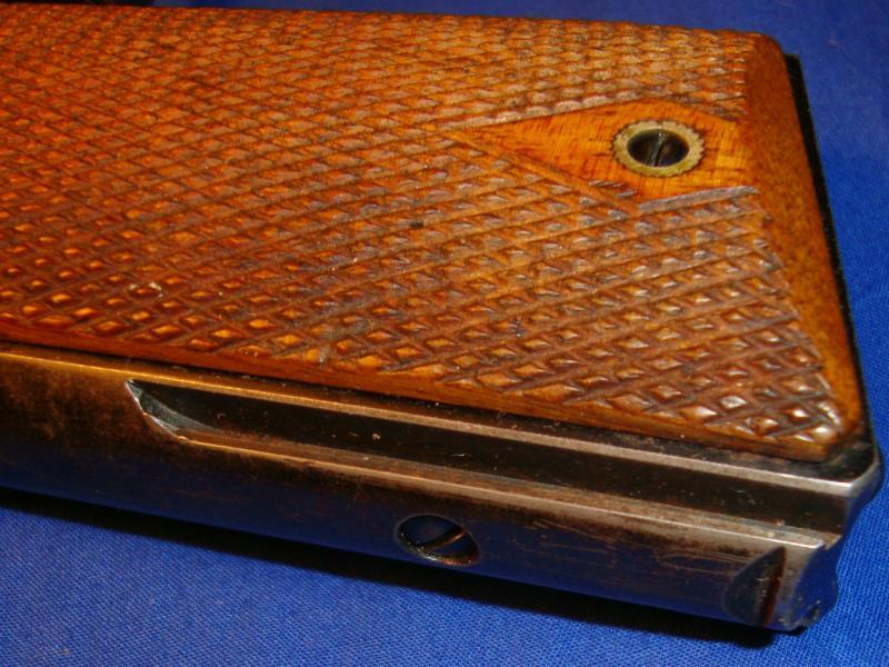

    The good:
    Minor discoloring in bore. No complaints here!
    Factory cut for and shipped with combo holster/shoulder stock. No stock currently, though!

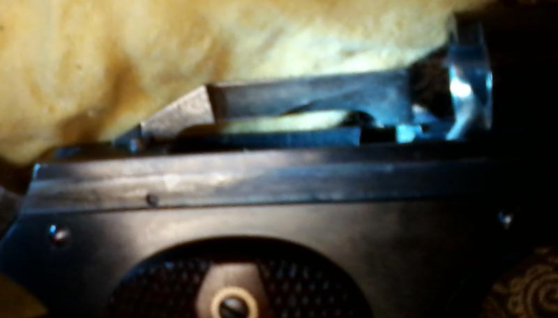

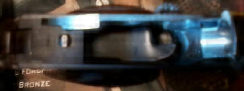

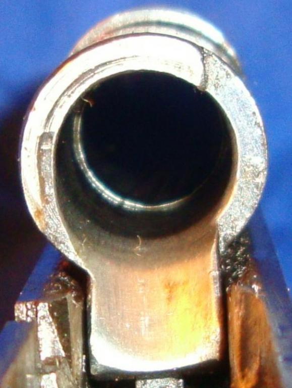

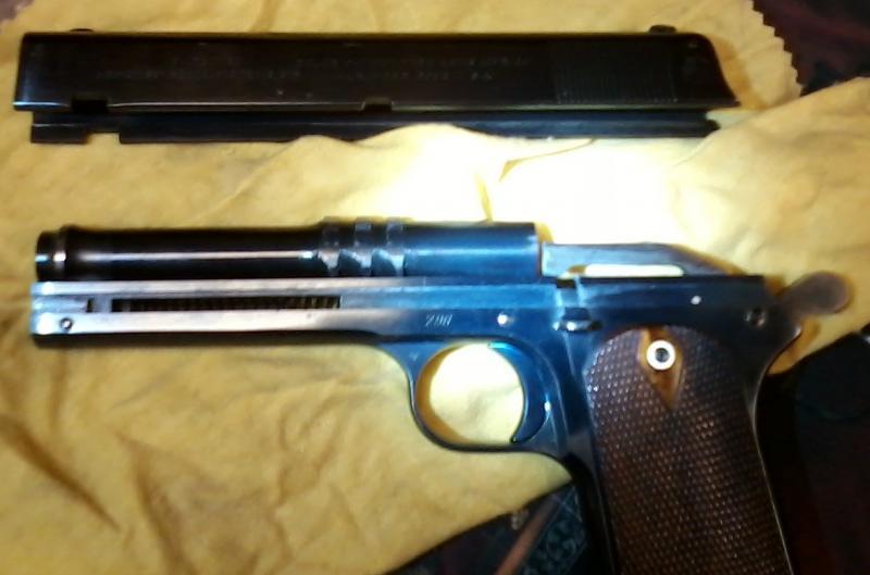

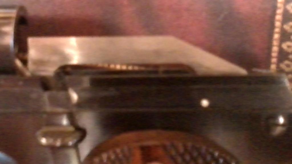

    Got a much appreciated assist from Jack Lesher, owner of Chuck's Firearms in Atlanta, GA. He has in his personal collection an early 1905. Working on getting a good drawing done with nominal dimensions, but if there's already info or parts out there, I'm still interested!
    Here's some phone camera photos that I cropped in an to attempt to focus on the part in question:
