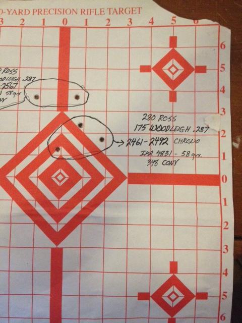

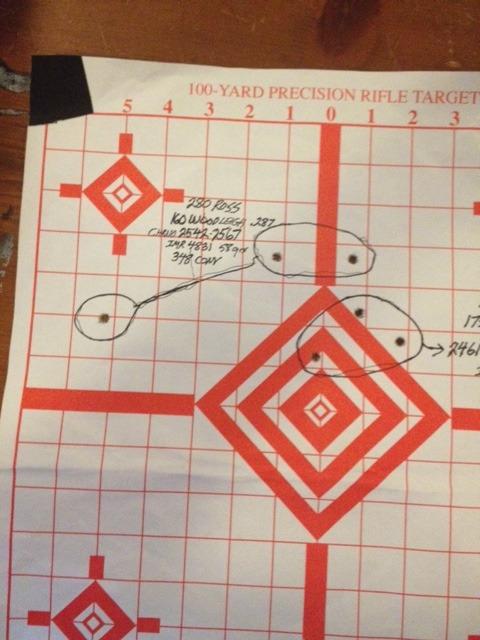

    Finally had time to do some shooting. As mentioned I was interested in comparing the .284 off the shelf 7mm bullets with the .287 bullets from Buffalo Arms and the Woodleighs I had acquired. Velocity difference between the Woodleigh .287 160gr bullet and Speer .284 160 gr with same load and powder was around 100fps.
    All rounds were shot with post of the Alaskan held at bottom of the diamond. Only one real alibi with the 160WL`s and I believe that was me not the rifle or bullet. Minute of deer with most of them with the 175WL and the 160 Speer at top of my list to go hunting.
    I didn`t load any of the Huntington brass yet.These were all Buffalo Arms 348 Win converted cases. Lost two with split necks even after annealing. Those cases have been reloaded numerous times and considering the reworking when formed from the 348`s am not surprised.
