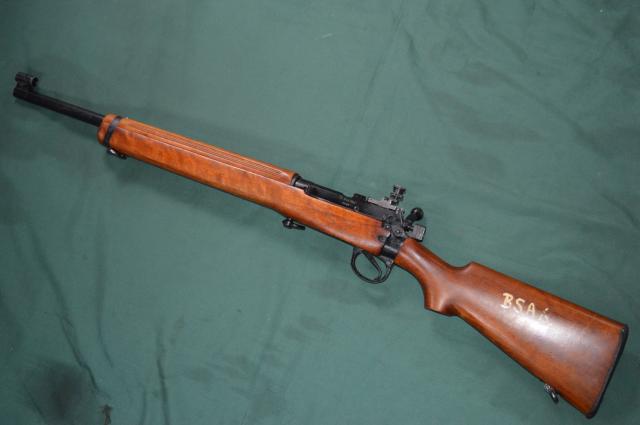

    Cadet .22 conversion of No4 rifle
    In the 1980s we were using .22 conversions of the No4 rifle for target practice in the Army Cadets. I remember that these rifles had the fore-end woodwork cut short similar to the No5 rifle and the foresight replaced. There was also a blanking plate over where the magazine would have been. Did these rifles have any form of official designation and were they converted to a standard pattern?

    Think your referring to the No 8

    Yep the N.8 but although based on No.4/5 component parts they were not conversions but rather built from the ground up as training rifles.

    Thanks for posting the picture, bigduke6, it looks familiar. I'm remembering back 35 years or so ago; I'm not certain about the rear sight but everything else looks just as I remember it. I remember there was a piece of metal brazed into the receiver where the magazine aperture would have been which you could see when the bolt was opened. This was, probably, what made me think that they were conversions of No4 rifles. I remember that they were lovely rifles to shoot and I always seemed to get reasonably good groupings with the rifles. Judging from what people have said over the last few years the U.K. government must have scrapped thousands and thousands of weapons, of historical interest, in recent years and got next to nothing for them in scrap metal value when they could have been sold to reputable dealers for a significant amount of money. Whoever thought up this ridiculous policy?
