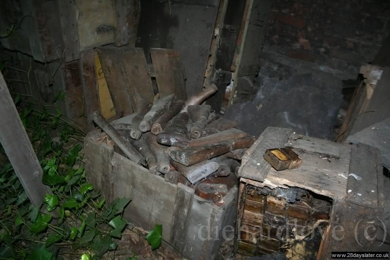

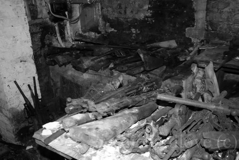

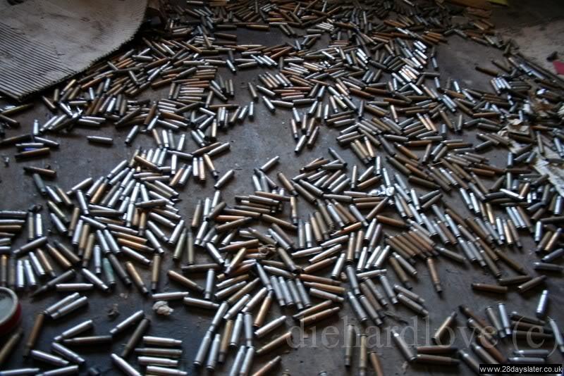

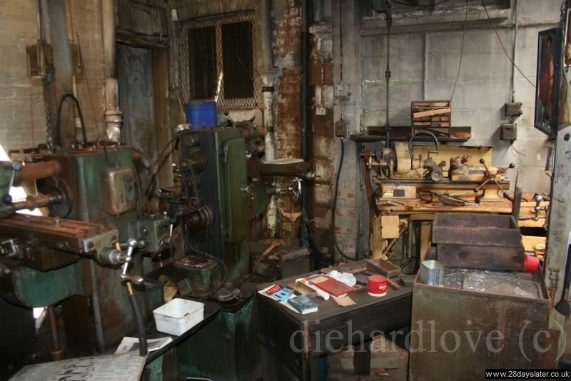

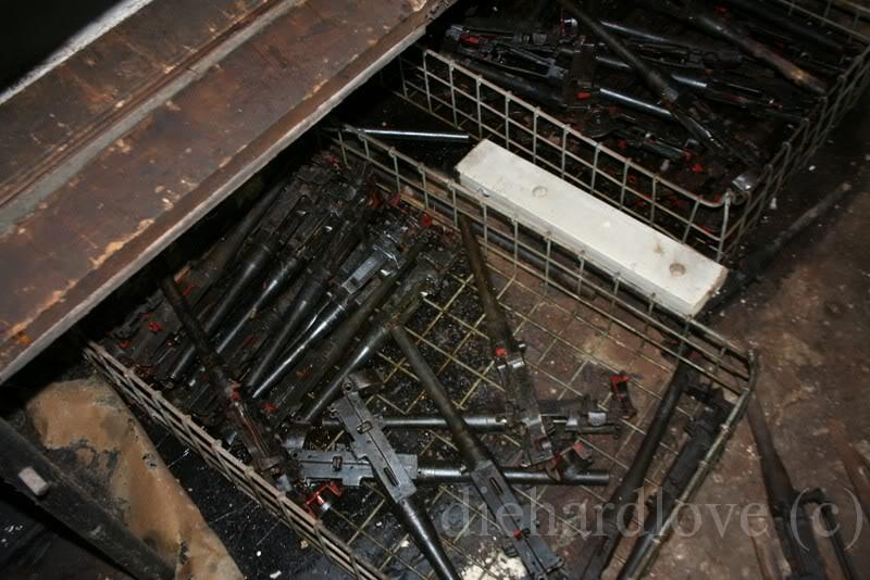

    Looking at that photo............ Jeeeees, how did they continue as long as they did. I bet it wasn't an ISO1991 registered Co with a workshop/store like that
    Nov 2007
    Today @ 04:18 PM
    Y Felinheli, Gogledd Cymru
    2,747
    Alan De Enfield
    10:42 PM
    That was part of the 'booty' that was left after PH closed the doors. "Industrial Archaeologists" broke in and found a 'lot of stuff' that shouldn't have been there.
    You may find some of the pics on this link of interest (a forum for Urban Industrial weirdo's)
    Report - - Parker Rifles The Gun Factory Birmingham 2010 | 28DaysLater.co.uk
    "....pulled up to this site to see 6 police officers talking to the squatter next door and checking this building was secure sat in my car for 2 hours till they left then had a look the front is barred up and secure and the back is hard to get at so i walked along brums main railway to the back of the building and jumped a fence ......."
    There are many other pictures and threads on this and other sites showing the PH factory.
