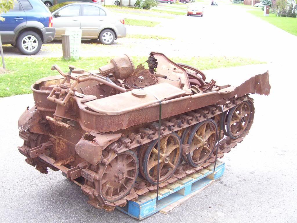

    If the interest is there I would like to show the restoration, in detail, of my Kettenkrad 116714 which was built in December of 1944 and is said, but undocumented, to be a Battle of the Bulge veteran. Currently there are only two Kettenkrads in Canadaicon, the one at the CWM and mine that has come a long way from the day a sad pile of expensive rust was deposited in my driveway. In N.America there is about a dozen or so Ketts and only about two hundred more "out there". As I was looking for a restoration project, I certainly got that and then some with my kett that had lived a hard life, been abused to no end, and was at that fork in the road of being either 1. parted out or 2. restored and brought back from the grave. Traveling from Belgiumicon to Texas and onwards to Ottawa the big day arrives when I see the vehicle that would take up the next three plus years of my life, and uncounted $$$, to make new again.

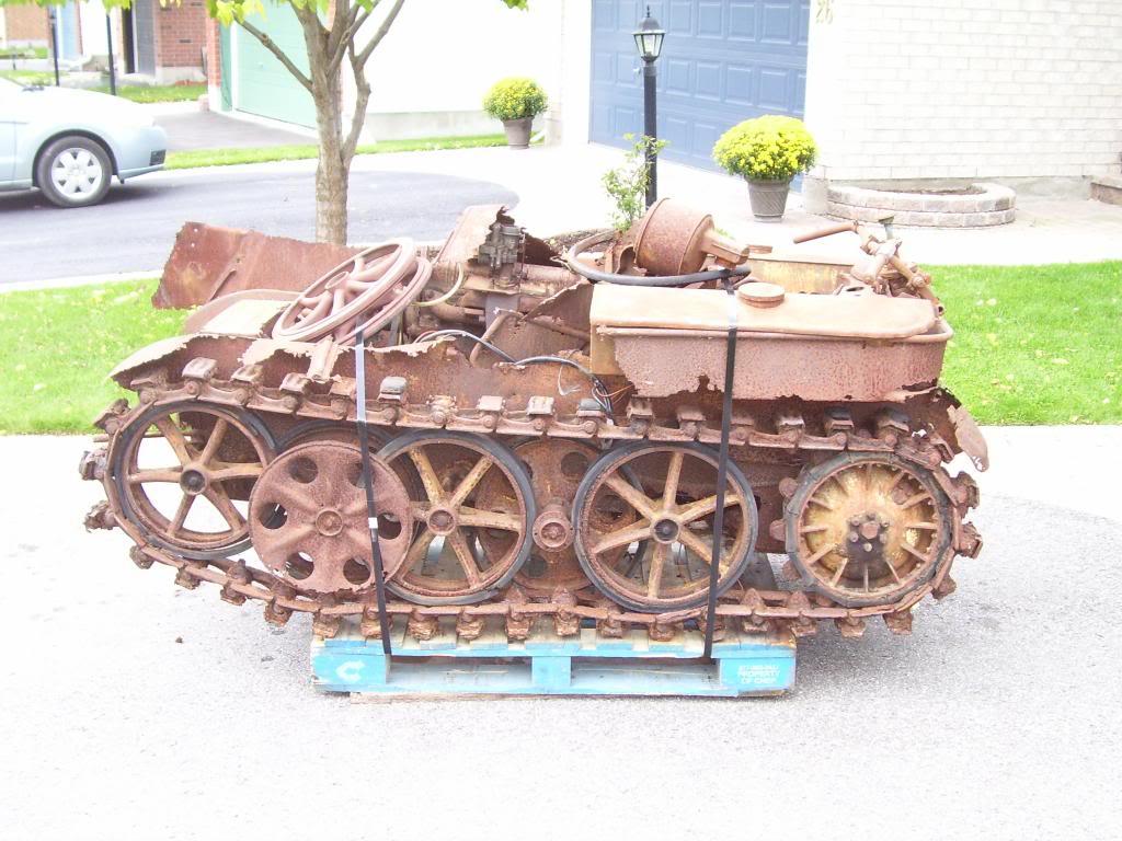

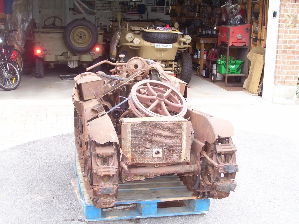

    One of the first orders of business was to take stock of what all came with the kett as the seller sent a big box of "stuff" that he had been setting aside if he may have been thinking of restoring it but thought otherwise after seeing it

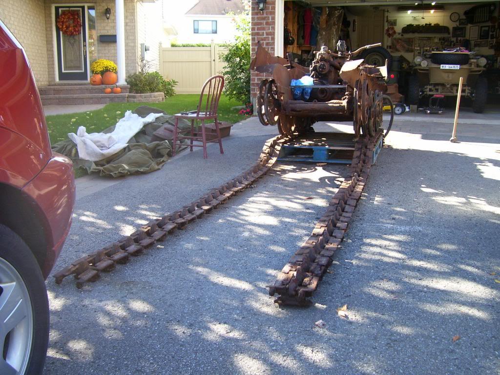

    The next thing to do was break track so I could roll the carcass about, suprisingly it rolls like a dream on its road wheels and when I opened the hubs the grease looked new and even more importantly about thirty sets of bearings I would not need to buy. That was all the more amazing as the kettenkrad had been found abandoned by the Germans by a farmer post battle then converted into a little bulldozer like vehicle to keep a creek running free to drive a water wheel at a mill. Note the angle iron pieces crudely welded to the front tow hooks where a blade had been fitted.
    Working on the track was trip down memory lane sound wise it it certainly brings one back to pounding Leopard Tank/Lynx or 113 track at least sound wise. Track rebuild will be the next installment.

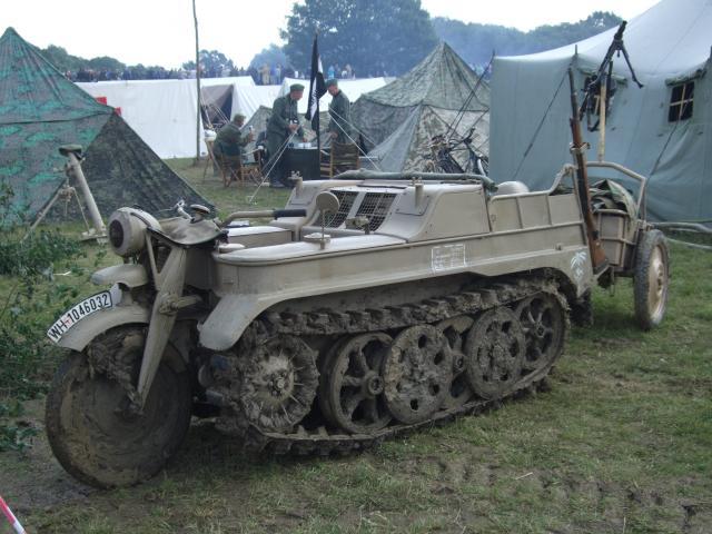

    Here is my Kettenkrad while it was in Belgium. Trust me it does not look anything like this now.

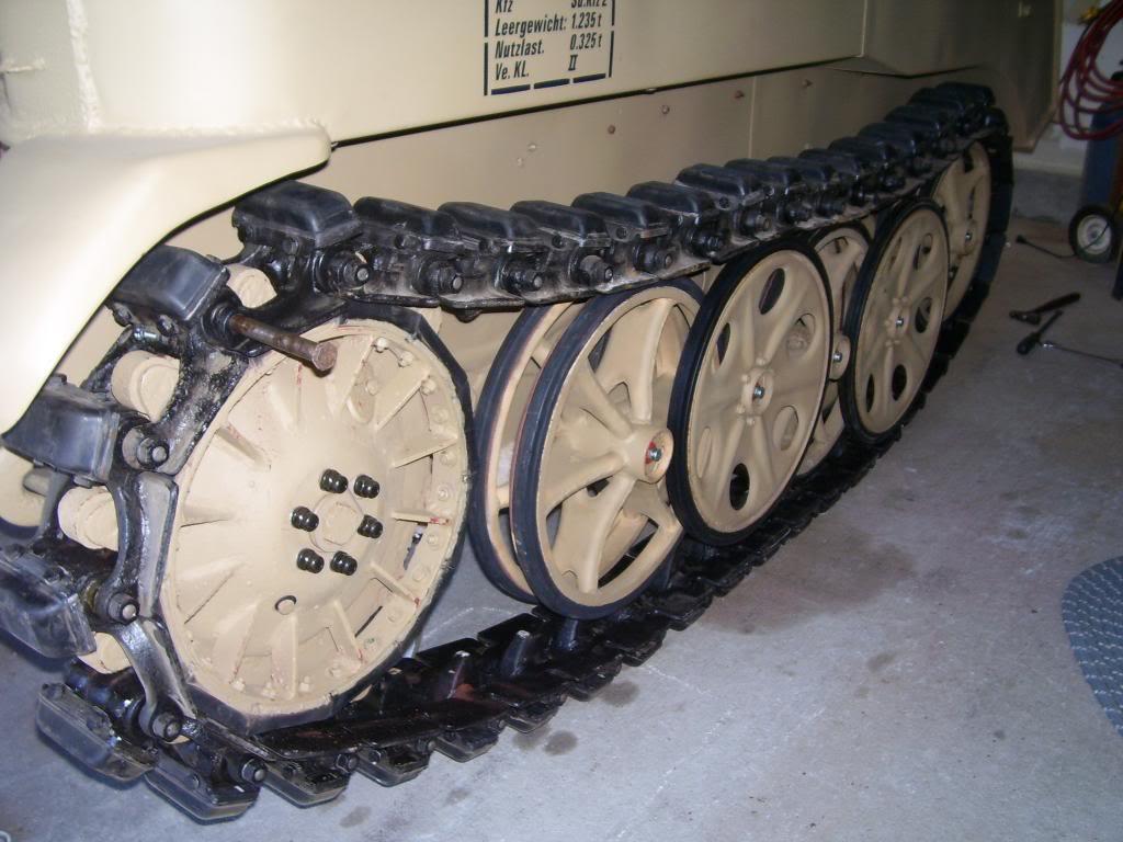

    First test fit of track.

    Breaking track on 116714.
    Rolling the old kettenkrad off its pallet, amazingly it rolled like a dream and most all of the bearings in the road wheels where in great condition.
    Once the kettenkrad was off the pallet and tracks I learned it still had a little life in it. Working with my back to it it silently started rolling down the driveway and was half ways to the road when I turned around and chased it back. Hence the strap to the MB.

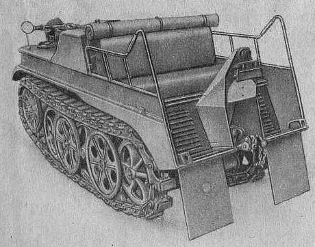

    Question for the original poster - was the late-war Kett slightly different in the body panels than early Ketts?
    This is a dwg from a Germanicon manual, most of the ketts I see look like this where there is a continuous ledge running from the too of the front fender back to below the rear handrails. (yes, I know the dwg shows hollow handrails vs. the later panelled versions)
    On your restored body though, the ledge is not there. Is that a purposeful or necessary result or expedient of your restoration, or is it a late-war time-saving mod to that style of body on 1944 ketts? Just curious

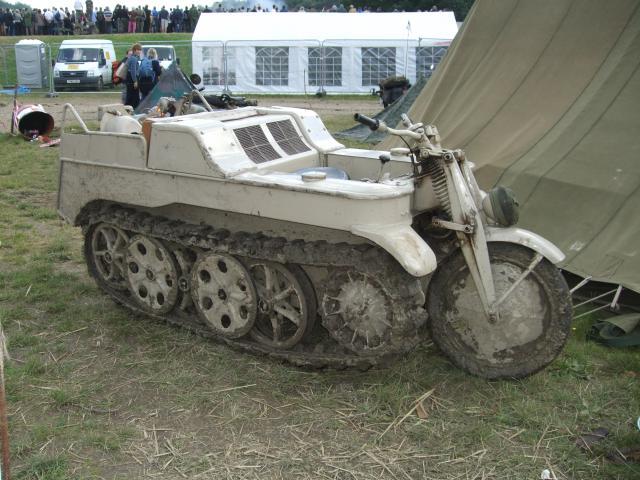

    One with one of the trailers Bruce mentions, and one on its own (War and Peace show 2012)
