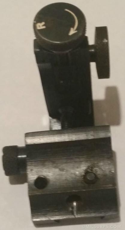

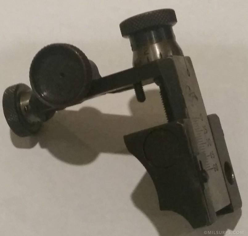

    Ok; my slide runs to 60. I'm still looking for information on how to mount it (only can see the screw head of 1 screw) and then I need to learn how to actually sight the rifle with it.

    Ok; checked mine tonight and the slide goes to 60. I'll try and attach pictures. My questions remain though; how do I mount it (I can see the one screw but not the head of the other) and how to I actually sight it? Thanks again for any help. https://www.milsurps.com/vbpgimage.p...7&d=1452736353

    The other screw is under the slide and the longer elevation slide version is the 48S. Don't screw around, take it to a gunsmith for mounting. Then go to the range and zero it at 100 yds, without moving the adjustments set the elevation stop screw then zero the elevation turret scale and slide the index (tiny pointer on the side with the slot) to "0" and you're done.
