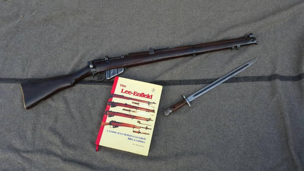

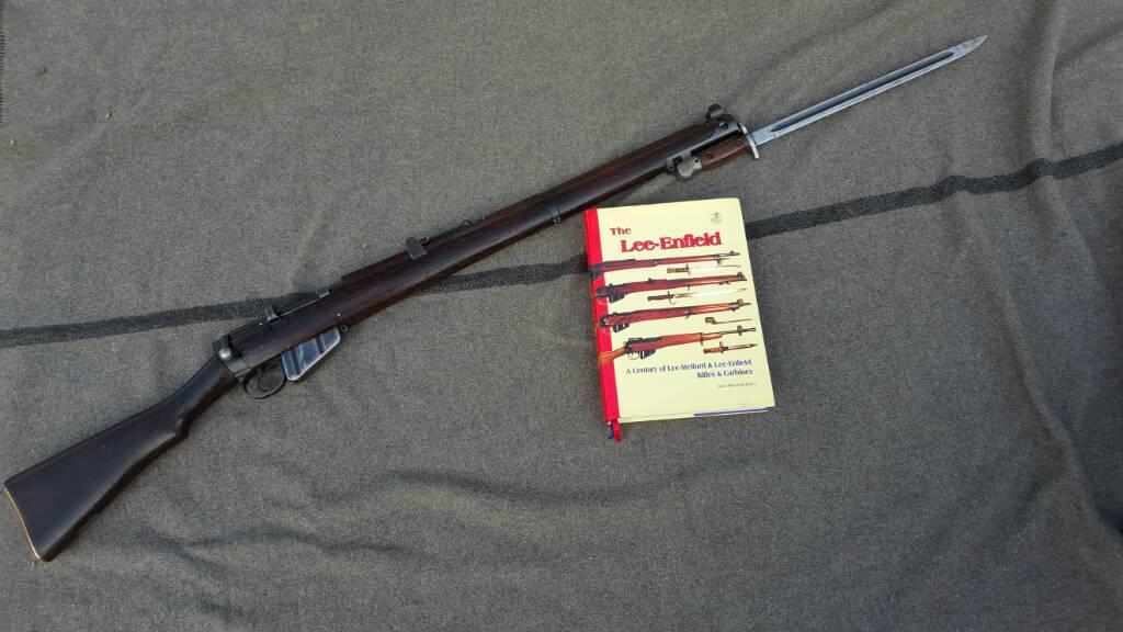

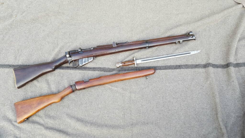

    This is a simple before and after of a project I did late in the fall.

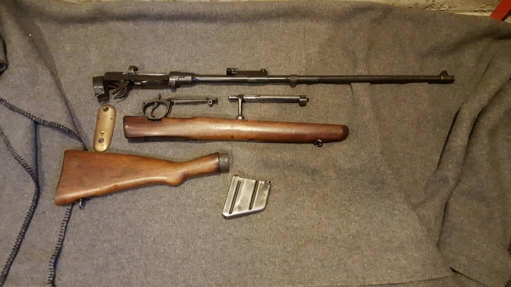

    This rifle was purchased as a very cheap sporter that turned out to be a gem.
    More details to follow!
    Sent from my SM-G920W8 using Tapatalk

    Nice to return them to standard. It looks great.

    Thanks for the comments!

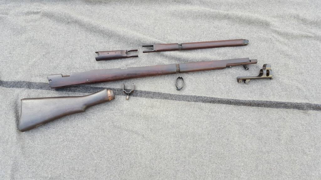

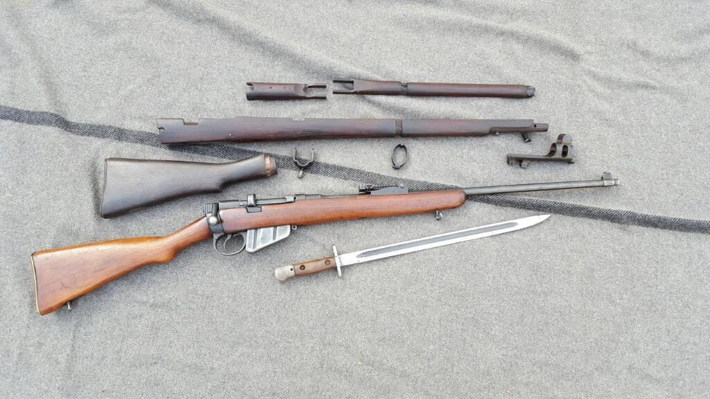

    The total build cost of this "restoration" is approximately 50% of market value of a similar rifle in Canadaicon,and since this was for my shooting collection, I wasn't too picky when sourcing the parts.
    The wood and hardware came from the same fellow who had been building a few LE's and decided to sell this set.
    The nosecap and rear sight protector (Not the rifle of course) are DP marked, in different fonts. The wood is very dark with a "S" short butt, and a small stock repair on the left side of the fore-end. The stock originally came with an aluminium butt plate, but I liked the look of brass and reused the one from the sporter stock.
    Speaking of the rifle, I checked it over prior to firing and it headspaced within military specification, and the bore was lead slugged to .312". I ran some commercial hunting ammunition through it and was able to smash a clay pigeon at 100m, prone unsupported after 3 windage corrections. I think there is potential in the rifle with a little more accuracy work on my end and some handloads.
    I do need a swivel and sling set, but that will come with time, I was initially worried that I would have an inaccurate slingshot from an untested rifle once the next stock was installed.
    - Darren

    The main test with the commercial stuff was more to ensure the gun wasn't going to pop and would shoot better than minute of barn door, I had another unknown LE to try that day, so I didn't even take paper targets, just a lead sled, and a length of string for the trigger, I only grabbed the clays in case things went well. While I did my due diligence before purchase, a guy never knows what gets done to a sporter. Some are great, some are very bad basketcases that need to be broken down for parts.
