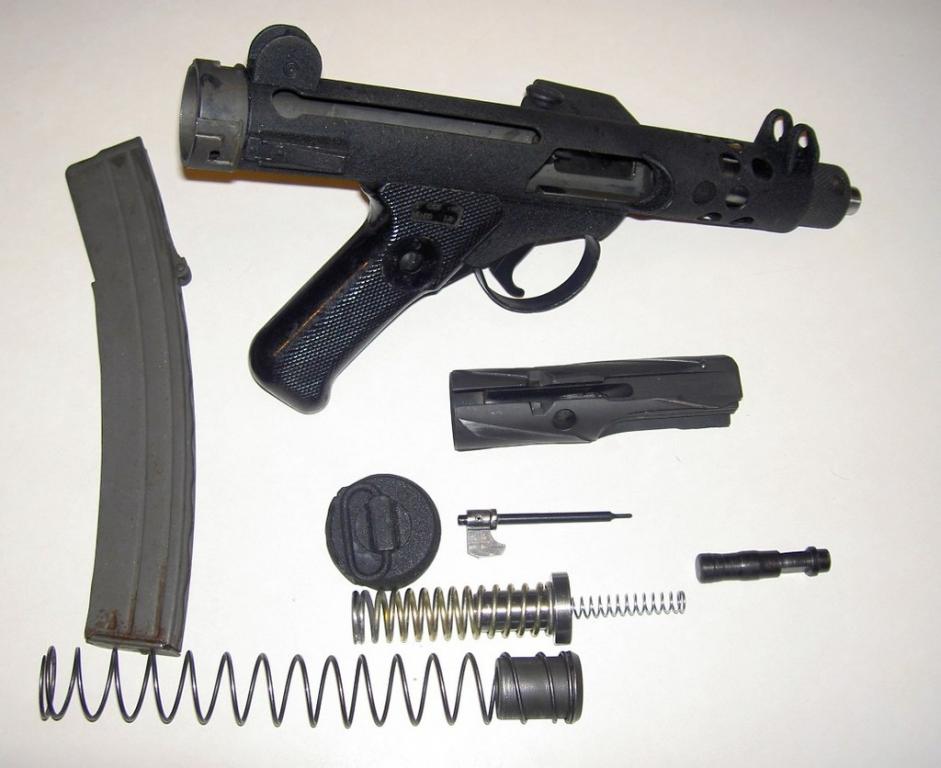

    9mm Wise Lite Arms “Colefire Magnum” – Sterling type pistol

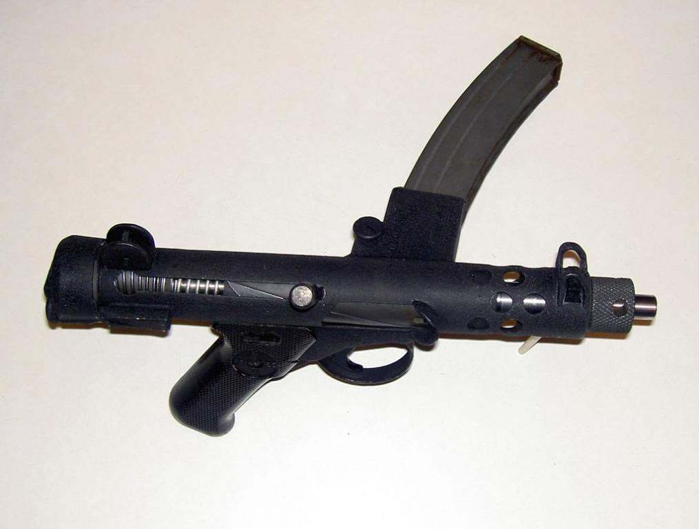

    WLA (Wise Lite Arms) made a Sterling type pistol they called the “Colefire Magnum.” It was made with a lot of Mk4 Sterling parts and chambered in 7.62x25mm. At the time 7.62x25mm was cheap. When the cheap ammo dried up people started parting out these pistols. I found the stripped receiver and decided to make a 9mm. I found some of the parts and made or converted the rest.

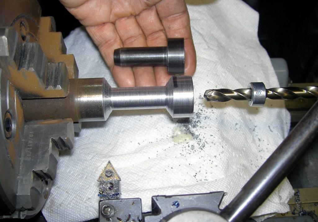

    A MK4 Sterling bolt being converted to a MK6.
    Copying a Mk6 firing spring retainer.
    The Mk6 firing spring retainer was too long. I copied this one from a picture on the net.

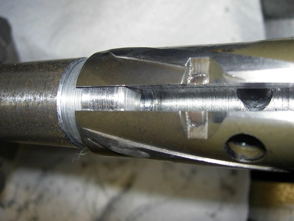

    I made the barrel from a blank.
    The short recoil makes a stiff spring necessary. The long cocking handle makes it easier and adds weight to the recoiling mass.
    There’s still a little left to finish up. I need to make the ratchet parts for the barrel nut, knurl the barrel, Parkerize the barrel & cocking handle & firing spring retainer.

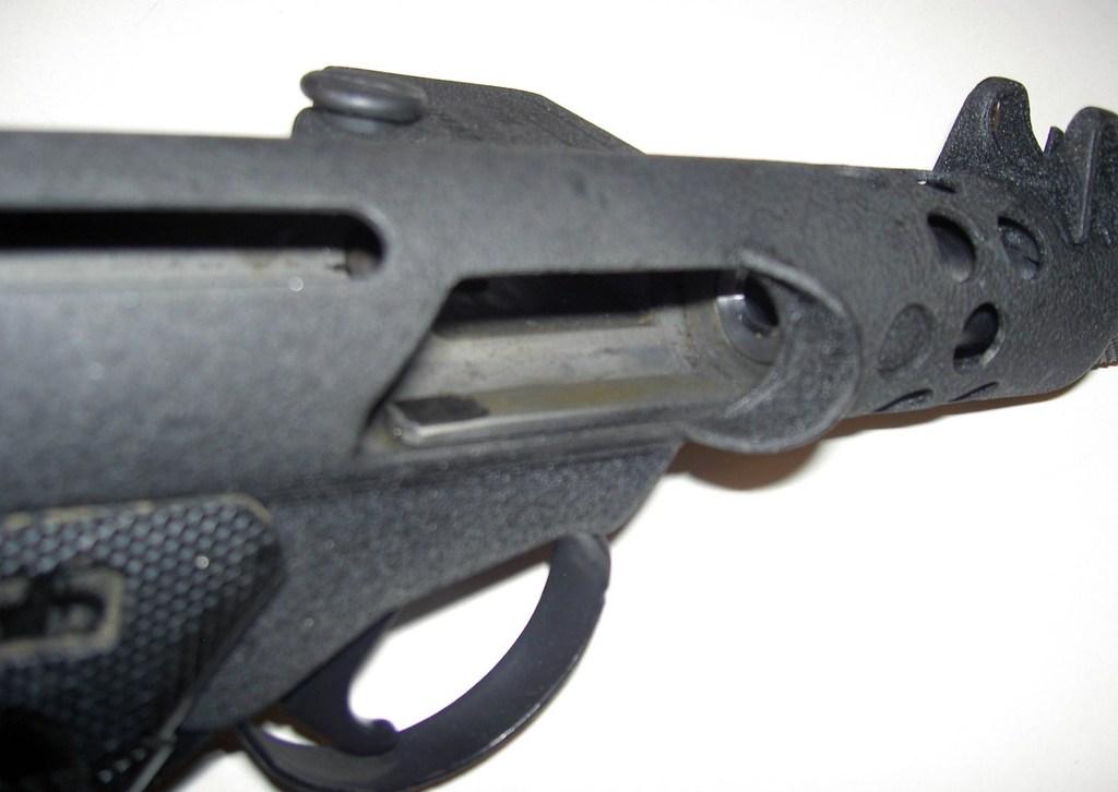

    This one is giving me a hard time. It’s not ejecting reliably.
    It always chambers the next round. But the casing from the fired round doesn’t always get ejected.
    I checked the extractor, plunger and spring. Also checked the ejector. They look fine.

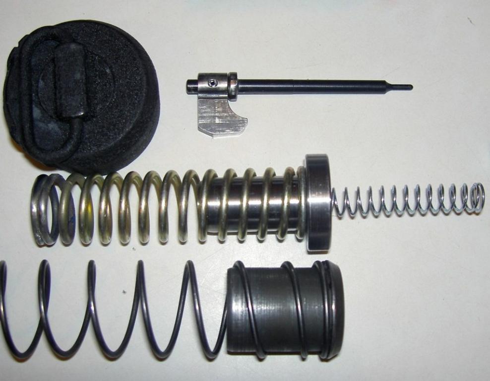

    The barrel is 4 ¼” long. I started out with the Mk7 pistol springs. It has a 4 ½” barrel and the bolt has the same weight. Then I trimmed the springs by taking one coil off and test firing. Then one more, test fire and so on. Eventually the return springs were so short they wouldn’t overpower the firing pin drive spring enough to close the bolt.
    I tried 4 different magazines that work fine in other Sterlings.
    I tried 115gr, 124gr, 147gr and 158gr rounds. All had the exact same problem.
    The bolt moves freely. It’s not binding.
    Dummy rounds hand cycle fine.
    If you have any thoughts please let me know.
    I will try a single spring tomorrow.
    On the bright side it’s pretty accurate for having such a short barrel.

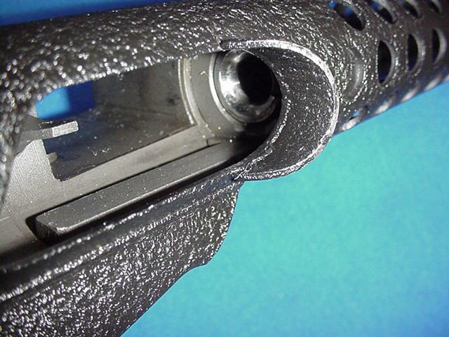

    Usually blow back autos will eject without need for an extractor...maybe try firing a round with the extractor removed?
    Did you try a known good extractor? perhaps the existing extractor was modified in some way for 7.62mm...
    and the alternate question is, did you polish the chamber? perhaps there is a burr at the bottom of the chamber or throat...
    How much shorter is that receiver tube than a Mk7 ? maybe there isn't enough travel for the bolt?

    Quote Originally Posted by Lee Enfield View Post
    Good idea. I will give it a try.
    No, it’s the first time I have used it. I will try another one.
    There is no modification for the extractor for 7.62x25mm.
    It extracts fine by hand.
    The chamber looked good. I didn’t polish it, just the feed radius.
    It’s 1.75” shorter than a Mk7. There’s plenty of room for the bolt to travel.
    I have fired one of these in 7.62x25mm and it never missed a beat.
    Thanks for the input. I will give them a try this coming weekend.

    You're correct in that a blow back will extract without an extractor but to say it will eject without an extractor is like saying that a car will corner when it detects a camber in the road. Yes, it will, AFTER A FASHION! But you can't rely on it. The actual extractor gives the spent case its definite direction. This is because there is a direct relationship between the radial angle of the extractor on the reciprocating breech face relative to the radial angle of the stationary* ejector which we used to call the mathematical (or angular?) tipping point and the direction of ejection.
    This described the problem exactly and got me to thinking. The spent cases were not spinning when they were ejected like you normally see with a Sterling. You can see them spinning in slow motion in this Mk5 video.
    So, something was interfering with the relationship between the extractor and the ejector. But what? And why did not do it when hand cycling rounds?
    By hand I could cycle the bolt and all 30 rounds would fly out spinning. Something was changing the extractor ejector relationship only when rounds were fired.
    When a round is fired the firing pin tip protrudes through the bolt face as it travels back past the ejector. That doesn’t happen when cycling rounds by hand. Then the firing pin is held back by the sear and the tip doesn’t protrude through the bolt.
    When I checked the firing pin protrusion it was more than double of what it should have been. It’s an aftermarket part. There are at least four different copies and they all differ slightly in length.
    With the new firing pin it ejects flawlessly. I wouldn’t have guessed the problem was the firing pin, but there you have it.
