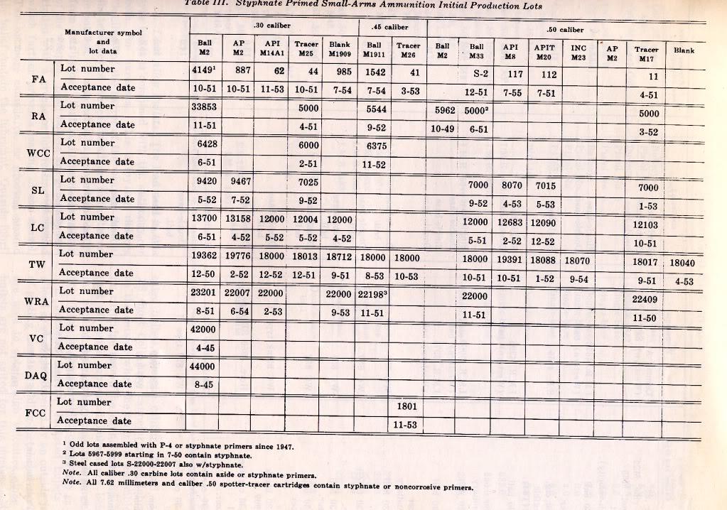

    Check the head stamp to determine if the ammo is corrosive primed or not. (assuming it is USGI ammo) If in doubt, clean the bore using the procedures for corrosive ammo. Modern bore solvent will not dissolve the chlorate salts.
    Refer to this chart to determine if your ammo is corrosive.

    Good call #4, I so rarely shoot corrosive 30-06 that it did not cross my mind. The 7.9x57, 7.62x54r and some of the 7.62x39 I have around is corrosive so I am tuned to be wary of it. If in doubt, clean as recommended and then do it again in two days. I may have to respectively disagree that there are several water based bore cleaners such as Hoppes Elite and MPro-7 or even Balistol and water 1:10 that should be able to remove Chlorate salts from corrosive primers. Be sure to oil properly as some my be really good degreasers.

    T7 Thompson Center black powder solvent. Boiling hot water. Windex and soap and water.
    ---------- Post added at 12:43 AM ---------- Previous post was at 12:41 AM ----------
    Oh and for M2 ball I believe anything date stamped after 1950 has non corrosive primers

    Also, I believe they issued AP as a standard issue during the Korean war. Of course it will be safe if it's issue... And treat as corrosive when you clean so there's no rust problem and you'll be fine.
