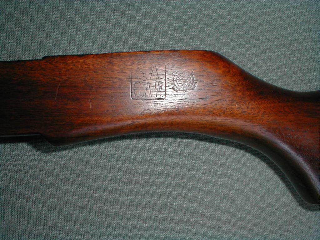

    SA GAW rebuild stamp
    I have seen the SA GAW rebuild stamp on M1icon rifle Winchester stocks and variations of the M1903 stock. Have never seen a carbine but it might be possible ? photo shows a Winchester M1 stock

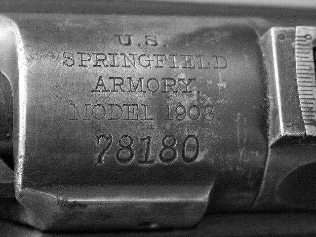

    Here's a picture of my 78180 rifle - you can see the obvious difference in the "script":
