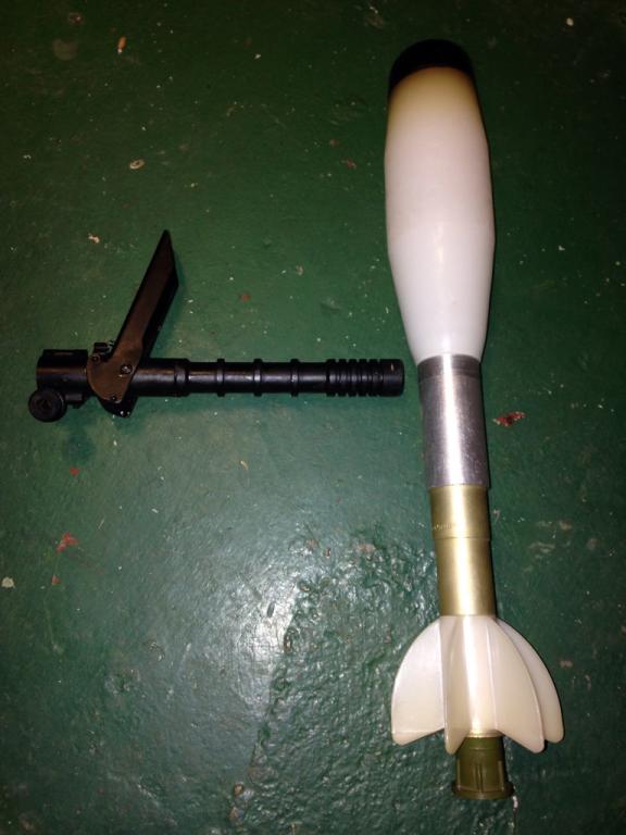

    I just picked up my first No4 Spigot grenade launcher and had question on how they were used. I know the cup launchers you fired with the butt on the ground like a small mortar. I have shot many a tennis ball for the kids this way. My question, is this the way the spigots were also fired? Ask this because there is flip up sight with graduations on the spigot launcher. They were not shot from the shoulder??

    Some examples could not find a pic of the No.4 being utilized some one else may be able to the Garandicon one they are firing a line out. The Germanicon one would have had some good recoil.

    It was in the book to fire them from the shoulder but we taught shooting from the ground. The sight was for shoulder or hip shooting. It wasn't very effective for aiming though. If you try to look up at the launcher when you fire, you get a face full of ballisite...in your eyes...

    Thanks for the info and the great photos. I think I will opt for the ground option. Save my shoulder and face.
    Here is my set up that I am going to try with my 1950 Long Branch.

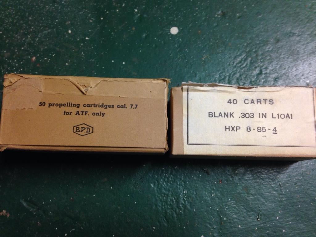

    I just picked up the practice grenade and have never launched one before. Any ideas on distance?

    It really all depends on which of the two types of launcher cartridges shown above that you are using. And the weight of the dummy of course

    And, be prepared for a hike after you fire it...
