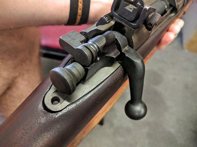

    First post and new to MILSURP rifles.Found a 1903a3 and I was attracted to it but not sure if it is all original or not.The research i have done is it dates back to July of 43 but the barrel stamp is july of 44.Cartouches seem correct but seems to have parkerized butt plate,,barrel bands and floor plate.Took these pics real quick to try to determine if it is mostly original or a mishmash of parts,,,,,if anyone can help please do so.

    I'm not a pro so I'll just say NICE looking stock, anyway! The rest is very presentable too, but I'm learning about the bolts and such. Does it have any marks on the bolt handle flat, above or below? A picture of that area, from the top, seems to help.

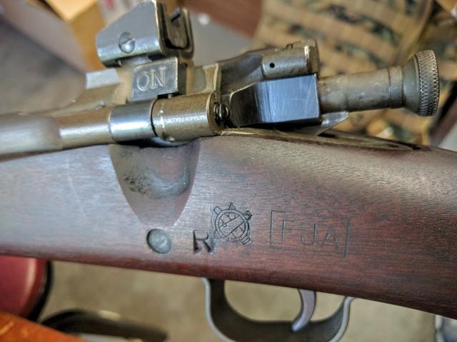

    rifle is a parts gun, stamps are fake as you can get, someone has sanded the relief cut for the cuttoff badly..unless its real cheap, id find another example

    Quote Originally Posted by chuckindenver View Post
    Not arguing with you, just want to learn. Why are the stamps fake? How can you tell?

    For the benefit of everyone on here and to promote learning the barrel is dated 7-44, which should be considered a replacement as Remington barrel dates of original 1903A3 rifles stopped at 3-44.This rifle is a good example of what can happen if a buyer doesn't do his or her research before forking over their money. Good on Kdog for posting and learning before buying.

    Is the stock earlier than the rest of the gun and someone has modified the woodwork to get it to fit together with the metalwork?

    Actually, the last "production" Remington M1903A3 barrels (fitted on finished production rifles) was 12-43 and maybe 1-44 - anything after is a replacement. I'd definitely be suspicious, at least of the RA - the "R" is a LOT "deeper" than the A.
