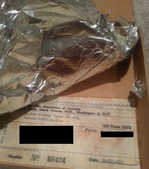

    Is this box a fake? Does the finish look original on the pistol? I read that there are many fakes. The stamp looks to have been applied after the finish.
    Under the wrap I found this. NRA 1962. The s/n matches the pistol.

    It looks honest. The slide has been heavily refinished which is typical. It's hard to believe but they actually put the parts in a huge sand tumbler to clean them. Simply awful! They were shipped direct from several U.S. Arsenals in the 1950's and 1960's in matching kraft boxes as purchased through NRA and DCM.

    I think the frame is original finish because the crossed cannons look as if they cut the finish when stamped. It might be the picture but it sure looks bright in spots to me. The slide is obviously heavily reParkerized as I mentioned above. They were disassembled, inspected, refinished if necessary and put back together with no intention of matching up original parts. It is what it is and looks to be just as shipped to the original buyer. I had one almost exactly like it as shipped to a buyer in Jacksonville, FL from San Antonio Arsenal in the 60's. It was a 1944 Colt production pistol.

    The finish on the pistol may be all original; photos need to be well lit with white light, & in focus. Also, we need to see the entire box, including the inside. Seeing the SN might help; the only valid reason to obscure it is if you believe that the gun is stolen. Only the inspectors initials & the DAS should have burnishing (bright metal showing); you may need a 10x loupe to see.

    The Remington Rand pistols that were new in the original shipping boxes as sold through the NRA/DCM were all late pistols in the 2.44 million range. The phosphate finish was a much lighter color than previous Remington Rands, and typically the slides were a shade darker than the receiver and the small parts quite a bit darker.
    Military 1911 and 1911A1 pistols were refinished by being sandblasted. Tumbling would have resulted in a bunch of beat up and damaged slides with the finish still on them.

    The finish on the pistol is most likely all original.
    Mr. Peppers can help with the box with good photos. The boxes are tough for me to know for sure.
    Johnny, I have seen 3 or 4 Remington Rands with box and some with both box and papers there were in other serial ranges, like 1.5 million and 2.2 million. I did not examine every detail as they were for sale and I was not buying. Have you seen any in this range? Fake papers and boxes, especially boxes, are becoming common.
