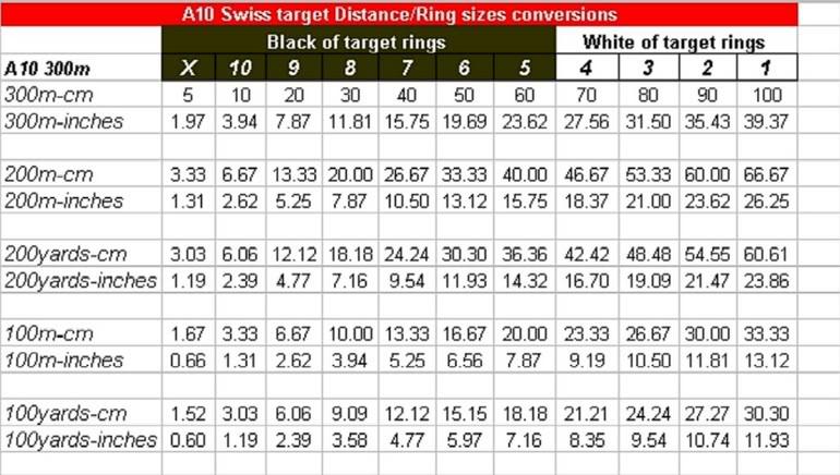

    The taller front sight blades for the K31 would fit, BUT still not tall enough for a center aim shot at 100yds with the minimum 300m K11 rear sight setting.
    I presume that is the distance you wish to use?
    I suggest putting up an aiming mark 20 inches below your current aimpoint on the target board.
    300m aiming is 6 o'clock hold on bottom of the black on Swissicon targets.
    Diameter of 300m Swiss target rings and equivalent at shorter distances.
