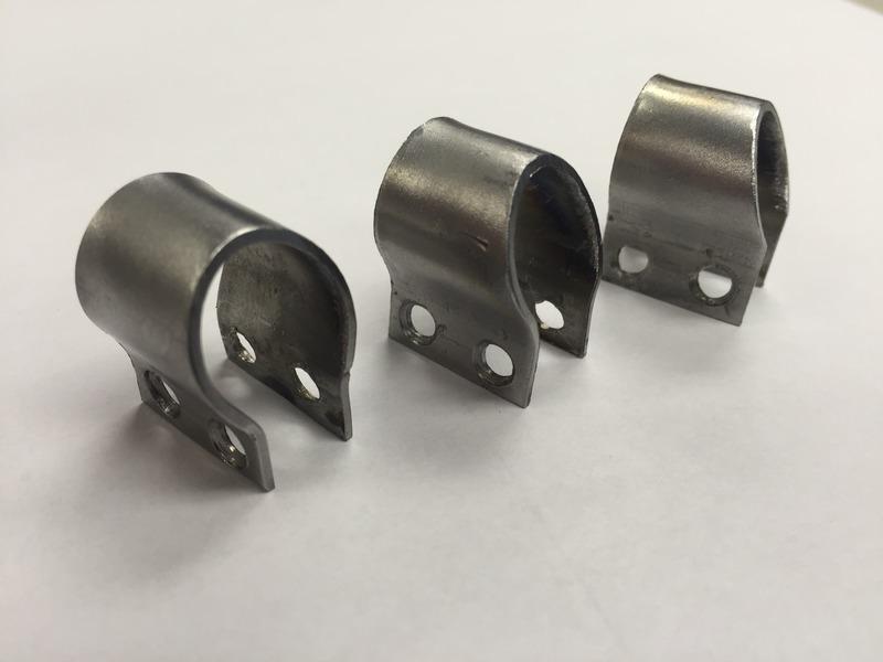

    Nose caps have been reproduced in plastic now. Steel ones are coming. Yes, I've been quite busy, but unfortunately it's been with working away from home for long periods of time. The stock orders are backed up, but I hope to blast through them with regularity this spring when I go back to trade school for a few months.

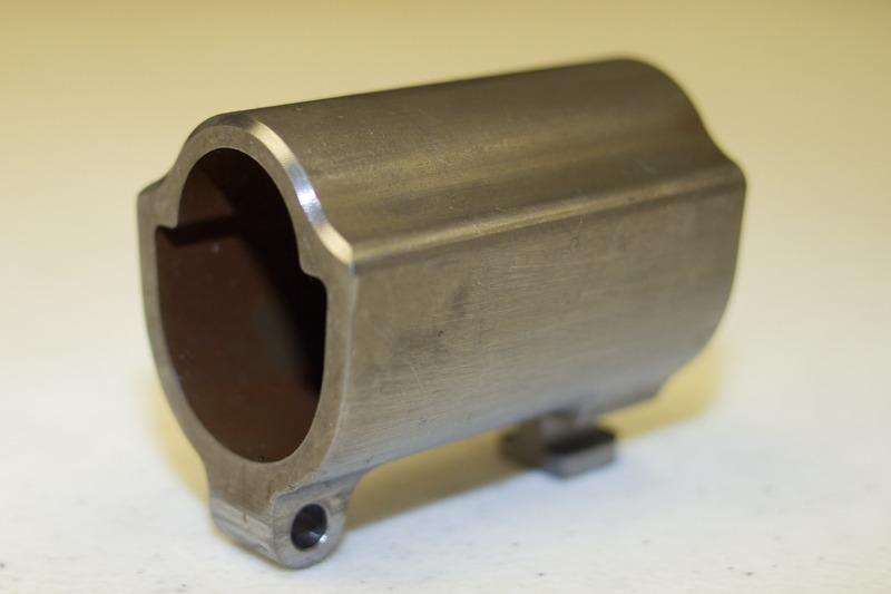

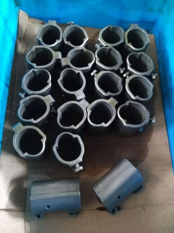

    Stocks are also available from Alberta Gun Stocks. Front bands and sight hoods I can supply those. Both are reproduction. The nose caps are produced by cnc, sight hoods are produced by hand.
    Now with a barrel!! That should be coming soon. For both 1905 and 1910.
