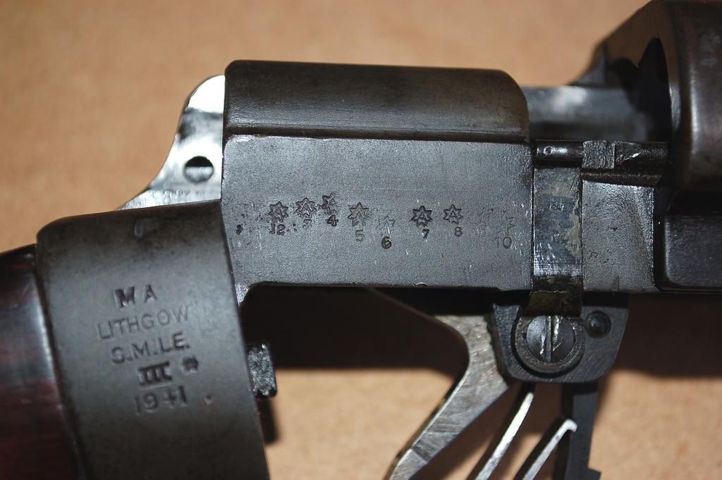

    I have this Lee Enfield no1 mk3* lithgow 1941 FTR 1957, the gun is in pretty good shape, I'm not sure but the forend used during the FTR (or by someone) comes from a cadet rifle because there are traces of yellow paint on it, I think all the parts including the magazine are Australianicon (with the brass barrel band), the bolt and the receiver match but the barrel has been force matched, bore is very good, I will probably sell it because I already have an Enfield 1919, what's a good price for a rifle like this one in Canadaicon?
    Any information on the markings and the rifle would be greatly appreciated.

    The re-numbering of the barrel is not exactly "forced matching", just the way things were done. The old number is still visible so that some idea of its provenance is retained in the Ordnance system. If a rifle got mangled by a truck running over the body, the rest would be savaged and fed back into the "system' as parts, or simply sent for "F.T.R." (Factory Thorough Repair.), a fancy name for "rebuild to current factory standards".
    This still happens today to some extent.
    The body also appears to have been re-marked on the right side of the breech ring at some stage

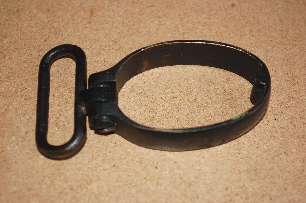

    There is a "trick" to removing that outer band with the sling swivel attached. The properly installed originals have the thread-end of the screw staked / spread. The end of this screw is even specially machined to enable this. The correct way to remove them is to carefully drill away the 'flared" bit. Failure to do this means you will cheerfully back a wildly oversized thread section through the thread in the band. Bad enough with the "malleable cast iron" version; totally destructive on the brass bands.
    Towards the end of the service life of these rifles, there was even an allowance for the use of a "substitute" BA threaded screw. The originals had a "special" Enfield thread. Not only that, EVERY time an armourer had to do ANYTHING that required the removal of the woodwork, the band had to be removed first, accompanied by the destruction of the screw.
    These BA substitutes were a little larger in diameter and after a little creative re-tapping of the band thread, did the job nicely.

    Nice rifle have a look at some local gun sites to see the condition of MkIII's they are selling based on yours and go from there. Prices can fluctuate a fair bit Lithgows over here range from $450 ~ $1200+/AU depending on condition the low to mid priced ones move the higher ones tend to stay there.
    Based on what I have seen on the market in Usedguns.com.au $600 ~ $700/AU would not be too exorbitant for that rifle based on the pics.

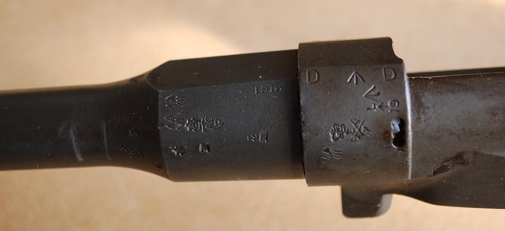

    I have to ask this one the milled out rear sight protectors with the Lithgowicon star aren't they WWI vintage or did they continue to mill them in WWII also stamping them MA, OA, BA without using the A in the star also how often did they stake the sear screw as none of my MKIII's or No.4's have had that done. Also I think on the left hand wrist strap faintly struck is that a P in a circle just near the safety lever at @3:00 o'clock Pic 18 that is for a parralel bore is this correct. Also pic 19 shows on the barrel stamped 1918 with the re-inforce a '19 date! TIA

    Cinders the sight protector is a reused part, as this was a practise that is very evident with Lithgowicon FTR's from the 50's and demonstrated well with this rifle. Even the action is scrubbed and renumbered. Sight protectors, nosecaps, trigger guards, magazines, butts bolts and barrels are other parts that you'll find as reused parts on a Lithgow FTR.
