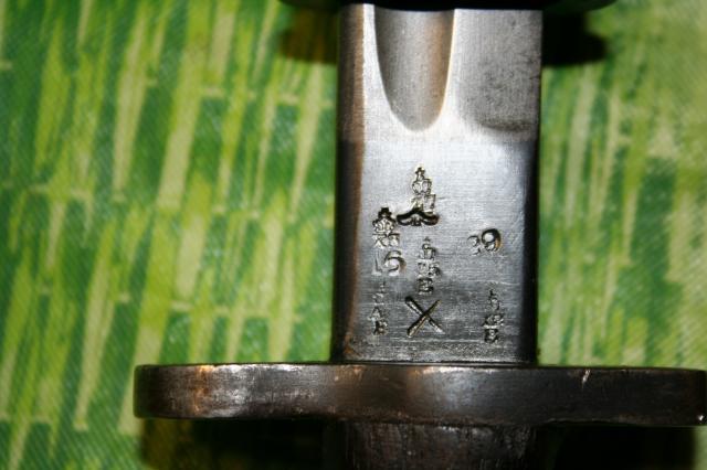

    In my opinion any first year production ((1916 Britishicon manufactured) MK III* would be considered early production. Keep in mind many were rearsenaled and lost many or some of their original parts. Is yours still in full wood or did it get sporterized. Pics are always welcome.
    ---------- Post added at 08:35 PM ---------- Previous post was at 08:33 PM ----------
    Ah thanks for the pics, how bout an overall of that old girl

    As requested:
