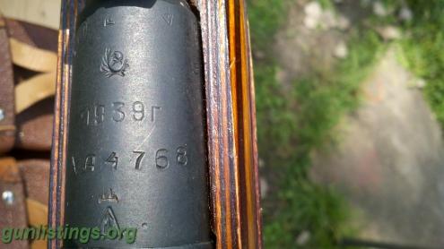

    jjjxlr8's Avatar
    Oct 2010
    10-18-2024 @ 05:16 PM
    Ohio
    200
    04-29-2025
    10:14 AM
    Here's some from #74
    Notice how light the mark is on the 1940 example.
    1937 with (refurbed)
    1938 without (non-refurbed)
    1939 with (refurb)
    1940 with (non-refurbed)
    another 1940 with (refurbed)
    1941 without (nazi refurb)
    1942 with (refurbed)
