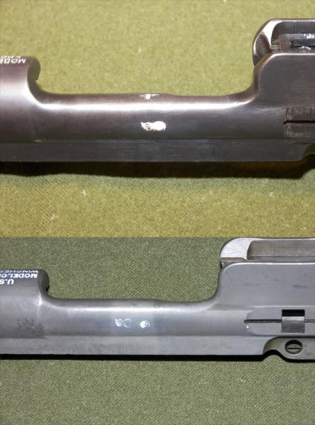

    Okay, what your seeing is the annealing of the receiver.
    Here is a pic with both a blued and parked receiver and you can see the difference in the finish on both of them.
    Dan
