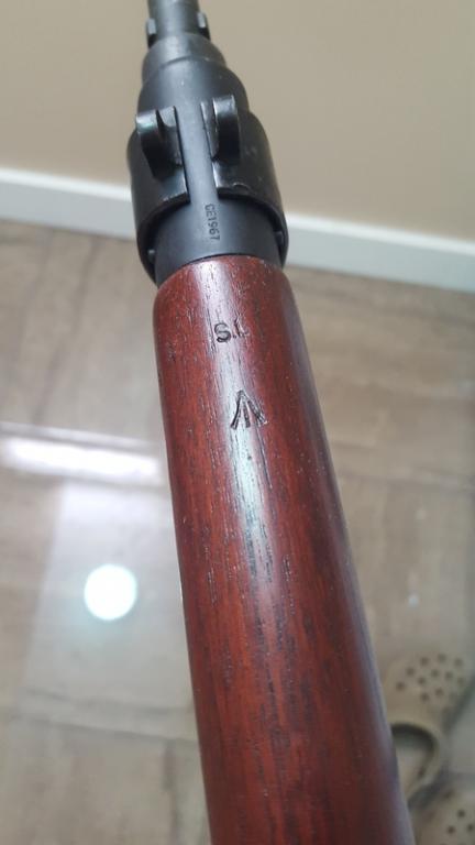

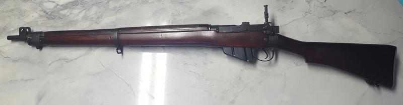

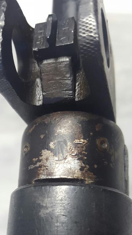

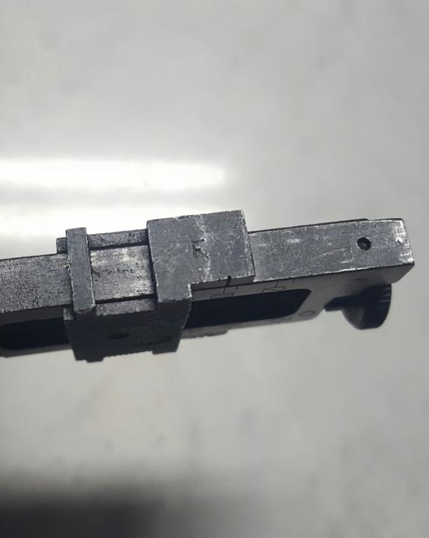

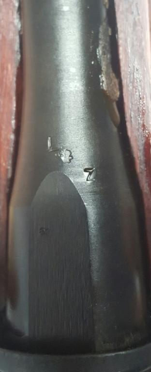

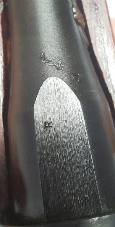

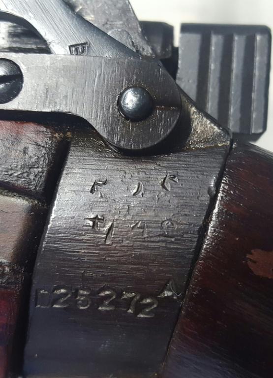

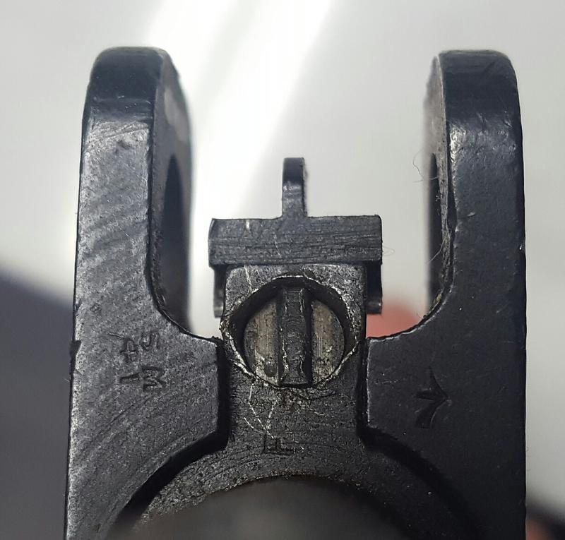

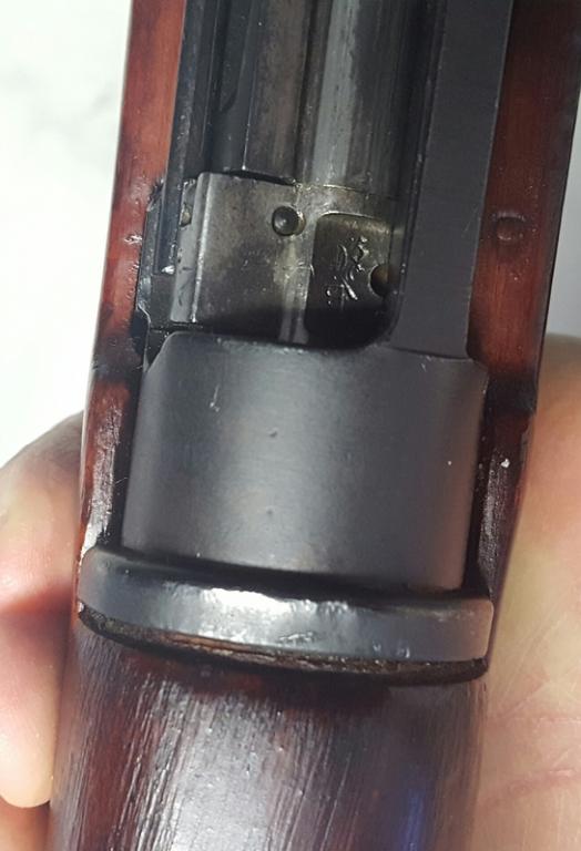

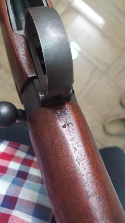

    OK here's a few snaps of what I could find without removing the forend.
    Roger Payne's Avatar
    Mar 2008
    Today @ 09:17 AM
    Sutton Coldfield, UK.
    3,548
    Roger Payne
    07-03-2025
    04:54 PM
    Faz April 42. As you have shown many of the parts bear the F of same factory. The SM41 on the foresight protector represents Singer Manufacturing & was produced in 1941 (Singer was a very common subcontractor). It also looks like your rifle has acquired a Long Branch safety at some point - not that that matters a jot so long as it does its job.

    Also, would this wood be more 'appropriate' as the wood I have is canadian stamped?

    On the butt socket left side you can just make out the '42 manufacture date
