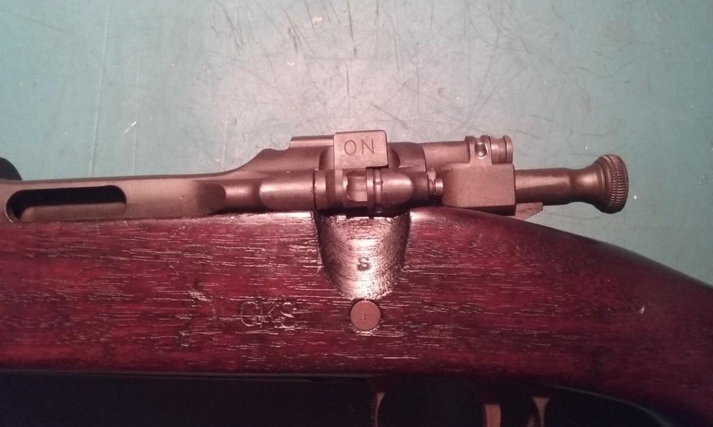

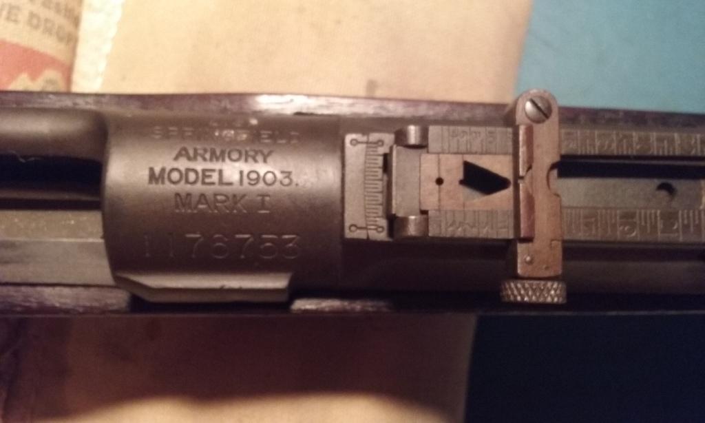

    Could someone please do a SRS search on my 2-20 dated 1903 MK 1 Please, serial number is: 1176753
    also I am looking for an "S" stock for it, what would be the correct Cartouches for my rifle. Thanks in advance.

    Your rifle would have a Mark I stock with a slight "notch" on the left side to clear the ejection port. The stock would be a grasping groove with a DAL or WJS stamp.

    Thanks Rick. I believe it would be worth trying to find an original stock for as it has its original MK1 parts.

    Sorry, no hit on 1903 Mk1 #1176753.
    ---------- Post added at 08:56 PM ---------- Previous post was at 08:54 PM ----------
    Cherokee5425, just post the serial number and ask. There are several on this forum that will do look ups.
