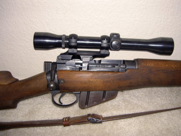

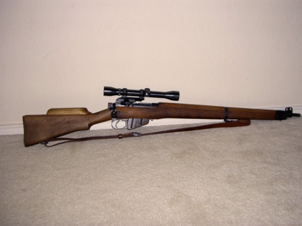

    I checked out the links above and after the clarification here on where the crayon goes, whittled this rest down and put it all together.
    I need to restain the rest, locktite the scope mount and rings, and test it out, but the scope height and cheek rest all give a nice eye relief and is comfortable.
    I did mount the scope with the turrets forward of both rings, the rear of the scope's eyepiece is ~1.5" behind the cocking piece, so it sits ok by me.
    A lot of the scope setups I have seen "look" to be WAY high and WAY too close to the eye.
    Will post pics sometime I hope.
