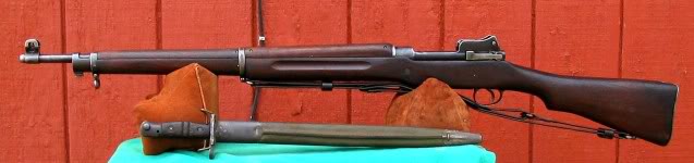

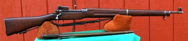

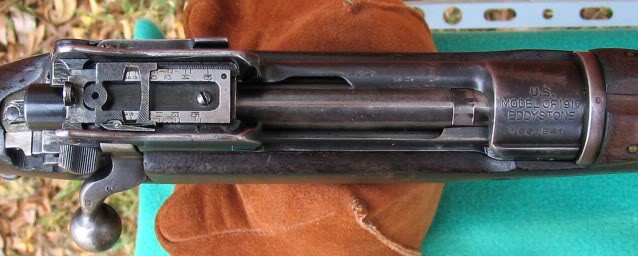

    According to the serial number the rifle was produced in September, 1918:

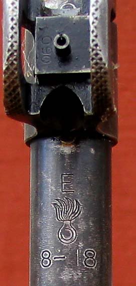

    The Eddystone marked barrel is dated August, 1918. I've been informed that this unusual front sight post is not uncommon to those M17s that have been in Canadianicon service:

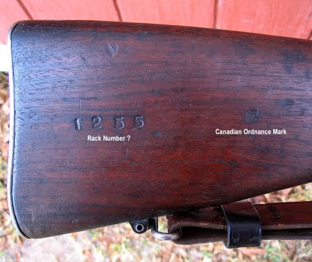

    The rifle has what appears to be a rack number and a Canadian Ordnance Stamp on the Buttstock:

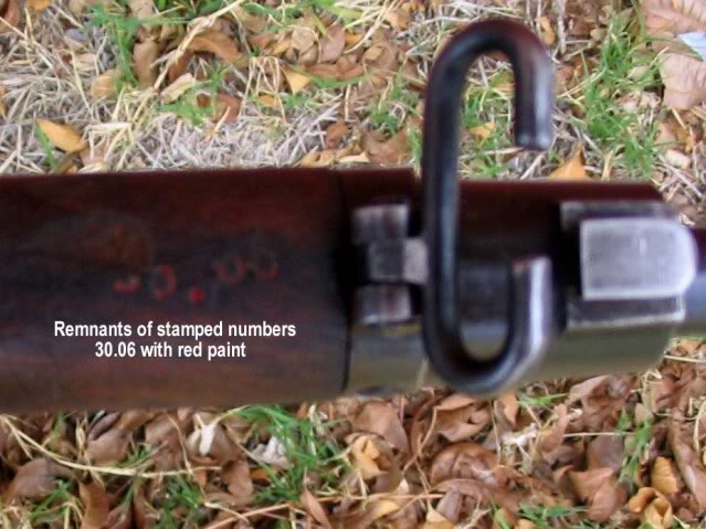

    The numbers 30.06 were stamped and once painted red on the bottom of the forestock behind the stacking swivel:

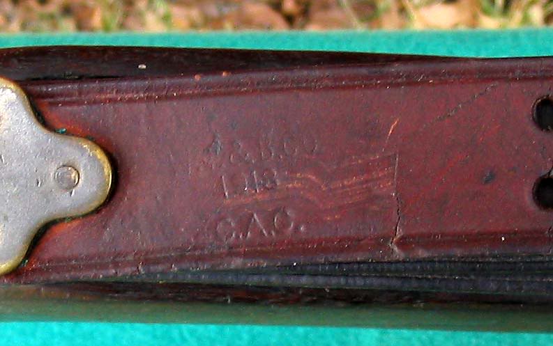

    Sling is marked: W. (?) & B. CO over 1918 over C.A.C.
    I would deeply appreciate any additional information anyone can provide about this rifle and its accouterments based on these photos.
    (There are CAI import marks stamped on the bottom of the barrel just behind the front sight band.)

    Canadianicon front sight? I think Danishicon front sight. They do run very well, by the way.

    agreed. a danish home guard front sight. some of these danish M1917s (M53/17), (from canadian lend/lease) may have been selected for accuracy and used in matches with the danish home guard. the front sight post arrangement made for more accurate sighting. you have a beautifull rifle there! it would appear that your rifle may have been sent to denmark directly from canada, unlike other M1917s which ended up in denmark via canada and norway (notched receivers). best, john

    Interesting rifle! Mine has the original Remington .075 front sight that is spot-on at 100 yards using the peep with the leaf down. The blade is too thin for a combat sight in my opinion at least, so the roll pin makes a lot of sense.
