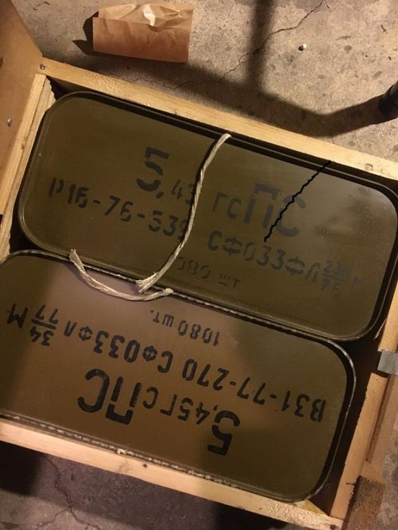

    Hello All,
    Investigating this case of two spam cans of apparently Russianicon surplus 5.45x39 and I have two questions:
    - date of manufacture (1976 and 77?)
    - are the primers likely to be corrosive?
    Thanks for any insight.

    5.45, rc = Steel Cartage Case, NC = Ball Ammo with a Steel Core
    B31 = Is the batch Number, 77= is the year it was made , 270 is the factory where it was made Sovieticon State Factory at Lugansk, Ukraine, 34/77 is the powder charge (34) and the powder production year (77)

    And the primers are not just likely corrosive, they are 100% corrosive. Clean the gas system well after use.
