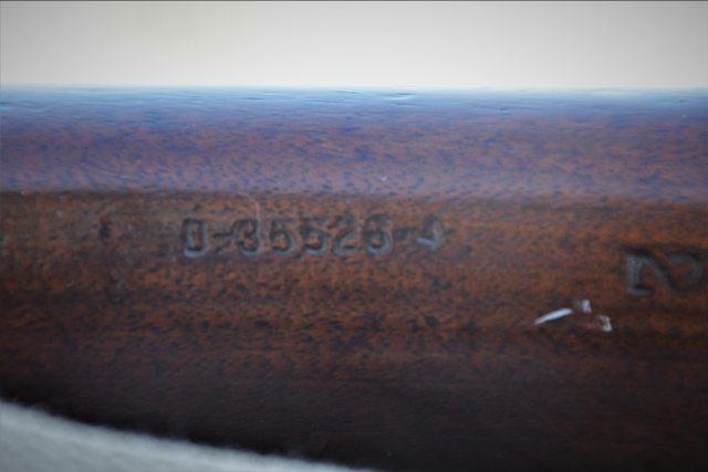

    On my Rock Island I have a stock i'm trying to ID. At some point i thought i read that the number IDed it as a NM stock but now i can't find that info to save my life.
    It has a lot of repairs done to it (none well) so worth is no longer an issue.

    The number is a drawing number version number 4. These were late WWII replacement part stock for the M1903, M1903A3 and A4 rifles.
    --fjruple

    D-35526
    D-35526 is an early "scant " stock part number.
    "-4" is a modification of the original design .
    John Beardicon would tell you it was as a result of Remington
    requesting a wider cut out for the tail of the
    receiver.
    Respectfully submitted
    Ed Byrns

    question of owner od D-35526-4 stock
    Sir
    Is the stock in question machine cut( not gnawed out) for 1903A3 receiver ring?
    Ed Byrns

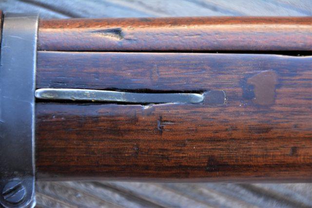

    My A4 with a late war replacement scant stock has similar wood filler repairs. That's how it was when received from CMPicon, along with a vertical pencil line on one side. That shows how desperate they were to keep up with demand for wood.

    Quote Originally Posted by eb2151 View Post
    Sir
    Ed Byrns
    Don't know haven't had the action out of the stock.

    One thing that interests me is the wide different in quality with Scant stocks - some of them look like they were crudely carved out of a bargain 2x4 byt a beginning woodworking student, while others, as far as workmanship, would stand with a NM stock.

    I'd say the OP is a pre and early-war Springfield stock. Can't say that I saw any wartime stocks with drawing numbers on them. Keystone, AB&B, MB and Embossing Co had the drawing numbers on the boxes but none on the stock "that I recall seeing". Got pics of the cutoff notch and front ring area? I expect there is an "S" in the cutoff.
