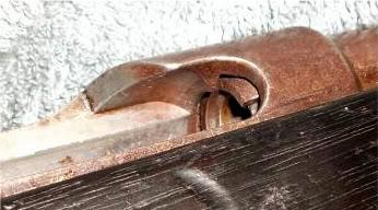

    The top rear of the receiver ring is angled to serve as the primary extraction cam. (A feature later incorporated into the Mosin Nagant design, amongst others. Is this the first appearance of this cam set-up?)
    The bolt handle placement of this model was quickly superseded in the "Model 1882" and following Lee designs. It is not as awkward as one might think, but neither is it optimal for most users.

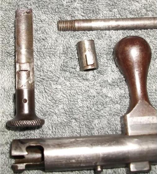

    The striker, striker spring and cocking piece won't change in execution much throughout the entire line of Lee turnbolt rifles. The lugged retaining collar, however, isn't seen again on Lee designs. Not a bad idea, though. What other firearms use this QD striker system?
    The purpose of the small vertical hole in the cocking piece eludes me for now. There's no corresponding hole through the striker, so it's not or a locking pin. Any ideas?
    Note that the cocking piece guide and guide cutout at the rear of the bolt body perform no other function at this point.
    #4b
    Note the wrenching flats on the striker forward of the spring seat collar. In the case of this rifle, no tools were required to unscrew the assembly.
    Below the striker front end are the extractor retainer on the left and the extractor on the right. There is no extractor spring, as such, but the retainer adds a spring like action when the extractor attempts to pivot. Explanation might get a bit lengthy, but basically, the retainer pushes downwards on the top of the extractor, forcing it to maintain close contact w/ the bolt body. (((This odd feature might deserve a whole post or two on it's own.)))

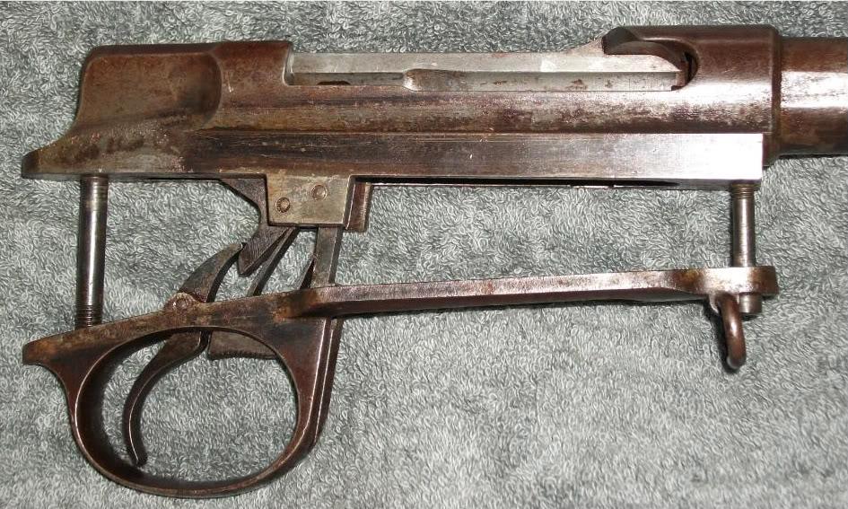

    Note that the split boss for the sear and magazine catch retaining pins also serves as the recoil lugs when bedded in the stock. If the wood sets back due to recoil or other rearward impacts (droppage or bayonet usage come to mind), there's not a lot of surface area to keep the action's rear tang from shifting back and splitting the stock. Perhaps this is the type of breakage that concerned the Britishicon evaluators. Thus, the L-E two piece stock! Purely conjecture on my part, but more plausible than a "weak wrist" which this rifle DOESN'T have!
    #2r

    "The purpose of the small vertical hole in the cocking piece eludes me for now. There's no corresponding hole through the striker, so it's not for a locking pin. Any ideas?"
    Probably an air escape hole. In that time period grease was used rather than oil. If too much was in a blind hole, when the firing pin was screwed in it could hinder proper seating at the bottom. Excess grease could escape through the small hole.
    "Note the wrenching flats on the striker forward of the spring seat collar. In the case of this rifle, no tools were required to unscrew the assembly."
    It looks like the extractor retainer could be used as a "tool" to unscrew the striker (firing pin). The slot in it looks very close to the same size as the flats in your pic. Does it fit?
