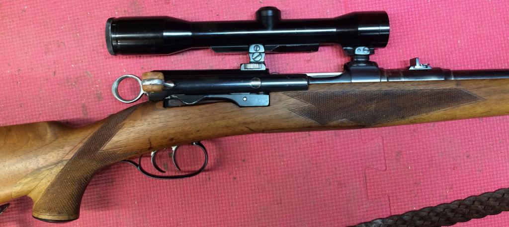

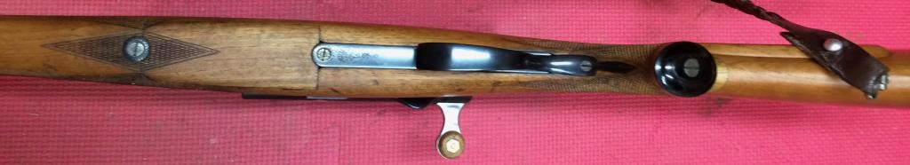

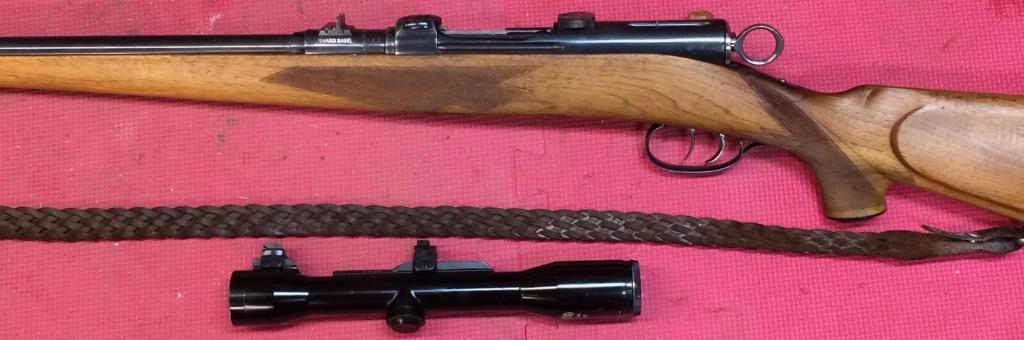

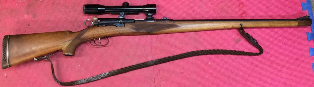

    Gday All
    I have just purchased the above rifle (see photos) and need some info on it.
    Already have handle on the cartridge, but it any one has any reloading info on it please forward.
    It seems to be a 96/11 rebarrelled in 10.3x60R, new sights, magazine blanked off with wood plug to make it a single shot and a palm scarfed into the butt.
    If the serial numbers are correct it would make it 1909 (No 332916).
    So if anyone could shed light on this firearm, I would be grateful.
    See attached photos
    regards
    BLue

    Ok so I can give the first bit of this firearms history. It was made in 1909 as a Gewehr 1889/96 rifle in the GP-90 round. Sometime during 1913-1920 this rifle would have then been converted to the Gewehr 96/11 configuration in GP-11. This rifle stayed in service until 1937 when it was privatized (that is what the P37 on your receiver means). From there it was sporterized by someone into the configuration it is in now.

    Thanks for the info
    I asked the same question on Swissrifle forum. Like you I thought the P37 was for privatising, but the person who replied to me on
    there said that because there is a full stop (period) in between the P and 37, that this was not the case, but a armourers mark.
    I havent seen any other examples of this on any other S-R rifle.
    I would expect to see these marks on a Lee enfield or such
    BLue

    I seriously question someone saying that it is a armourers mark. Especially considering it is right where they put the Privatization mark. If you go here, it says the P.37 is a privatization mark as well.

    The first rifle has had some work done but it seems an enthusiastic knowledgeable amateur. The second rifle really looks professionally good. Both definitely not cheap butchered.
