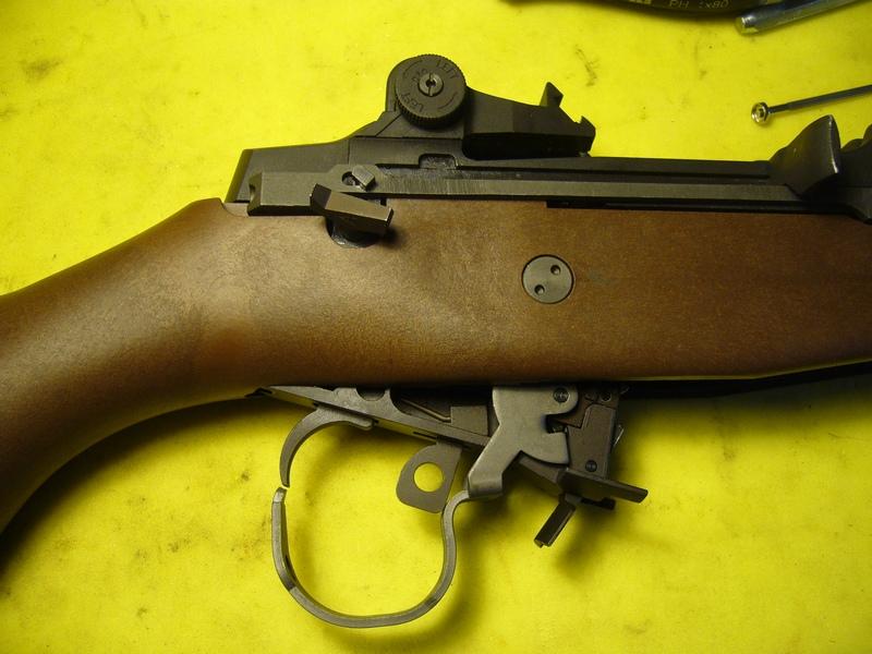

    hello I hope you can see the image taken on the internet but shows the operation that I can not do because the trigger guard in pulling it up is blocked before and does not allow me to disassemble the weapon

    Quote Originally Posted by Wanaxit View Post
    https://www.milsurps.com/images/impo...p1070440-1.jpg
    thank you
    Wanaxit-- I see three issues in your picture. first The selector switch is not locked into either a FA or semi-auto position. This will effect the alignment of the selector switch with the sear on the trigger. Second the triggerguard is not fully extended in an open position. The hammer should be in a cocked position. Third the triggerguard assembly is not properly aligned with the triggerguard assembly track in the rear of the receiver. You will never get it in in that position. If it is a new stock that is being installed, it may have to be fitted.

    hello and thanks for replying
    I took the image on the internet and it is not my weapon, it was an example of what I can not do, that is to raise the guard of the trigger, it reaches up to a point then it stops letting me not to remove the trigger group
