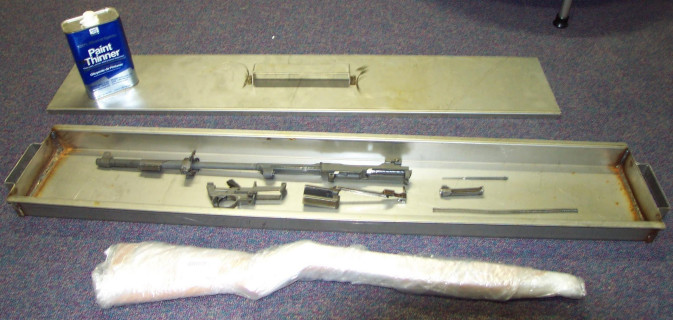

    Legacy Member Faulkner's Avatar
    07-13-2024 @ 05:20 PM
    Arkansas Ozarks
    136
    01:36 AM
    Quote Originally Posted by U.S.iconG.I. View Post
    I soak my metal in mineral spirits over night myself. Comes off very easy the next morning.
    Jeff
    +1
    I had a buddy of mine make me a tray with a lid. I soak it all night and it's real easy to get off the next day.
    - change it back -
