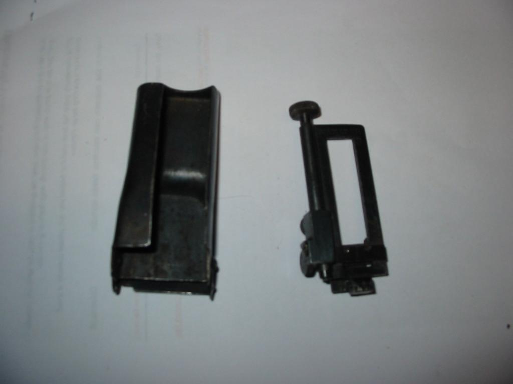

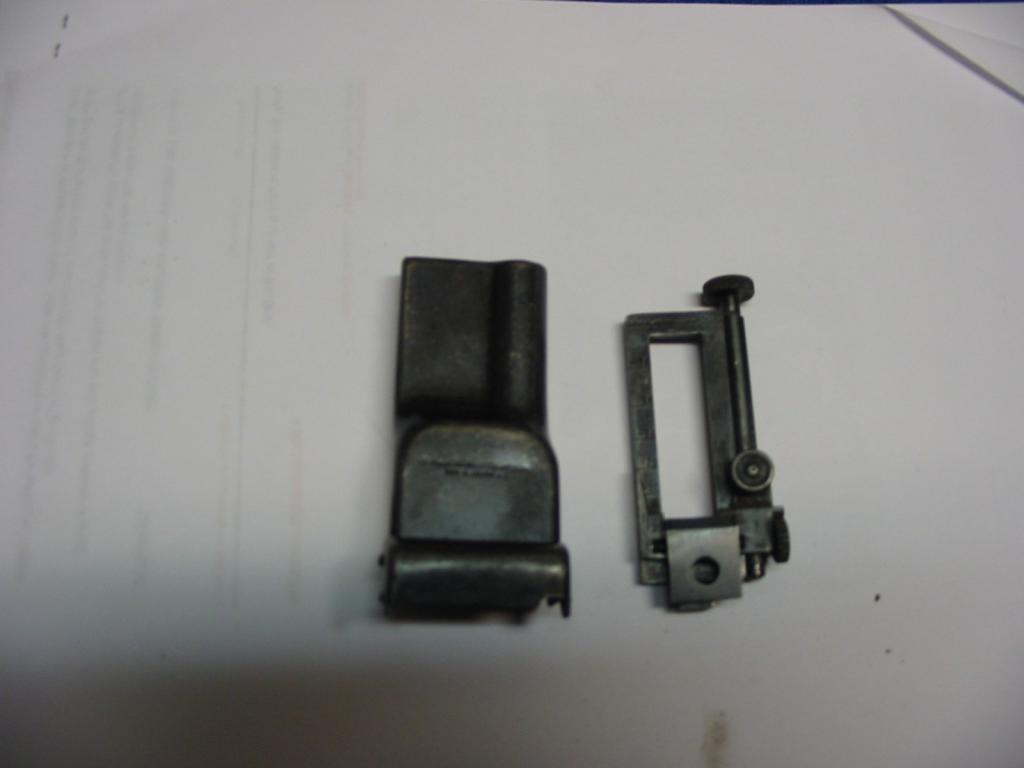

    I just purchased this Sutherland target sight for my Ross Mk II** restoration project. More on that later. I have yet to receive the sight, but need to source an eye cup for it. Could someone please tell me what the thread diameter and pitch are and, perhaps, what other makes take the same thread? I feel especially fortunate that the cover is included.
    As always, any and all assistance is much appreciated.

    The cover is a very rare item.

    That might explain why I had no idea such a thing existed
