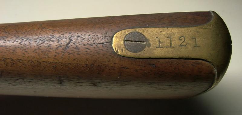

    I requested Joe Bilby’s help regarding this gun because of the numbers seen on the butt tang and this is the story that unfolded.

    I emailed Joe Bilby on March 10 2006 with photos of the Butt tang marking “1121” as well as the “24” bore marking on the barrel.

    Joe, do the markings on the butt plate tang of this Enfield fit any kind of Civil War markings pattern that you are familiar with?
    Thanks again for your help.

    I'll forward it to my Enfield expert and get back to you. The "24" on the barrel indicates the guns bore size, which is .58 calibers rather than the standard "25 bore" or Britishicon .577. This is one indication that the gun may be a Union import.

    While it's difficult to positively ID anything and to determine legitimacy from a photo, the piece seems to be a CS central government purchase. 1121 is the "control number." If the ramrod is original to the piece, it will also have 1121 engraved on it near the jag head. There should have been a large serif letter in front of the butt plate tang, but the stock seems to have been scraped. On the bottom of the stock behind the trigger guard, there should be two commission broker's stamps and a JS anchor stamp. The stampings behind the trigger guards were often light. Lacking the anchor stamp, there should be either a G or an SC on the lock side of the butt stock for this particular number range.
    Some of the numbered arms can be traced to the vessel and the jobber, but - this is the big hole in the argument presented by the high-rolling dealers - there are only extant records for 2,000 arms that were brought into Savannah. Most CS dealers like to lead the buyer to believe that there are records for 30,000 numbered arms.
    If I ever get my book done, I will attempt to uncloud some of the mystery. Brit regulations specified that all arms were to have a number not to exceed four digits engraved "and in no instance stamped or punched" on the butt plate, the ramrod, the bayonet socket, the bayonet scabbard stud, and the waist belt. In short, each stand of arms had all of the components numbered together. The Confederates followed the same practice at first, but then realized that it was a waste of time. The Confederates also used a few other numbering methods, and several states also had their own numbering systems. Many Army of Tennessee arms had an additional mark applied.
    The piece is not a Brit issue as it lacks the army proof house markings - even arms bought commercially for Brit service were normally reproofed at an army proof house.
    The piece in the photo you sent is a Grade 2 handmade arm with filed flat-headed mount screws.

    Still probably Confederate.

    Surprised me as well. But I think the early Confederate orders might have been 24 bore. My friend, who is an expert in these matters, says he is almost positive it is Confederate, with the number on the buttplate and the 24 bore marking. You made a really good buy. :-)

    I will, but as my buddy advises, you still got 90% to go before you can call it Confederate definitively -- but you got a good possibility. :-)
    He also advises that some Enfields made for the US, in 24 bore, in the early part of the war, were actually bought by the Rebels, and that might explain the bore size.

    My buddy is “Jack”, who has been amassing info on Enfields and Rebel firearms in general for many years. The "90%" means that the number on the buttstock is a sign, but that, unfortunately, the other markings he mentioned are either not there or have been removed over the years -- still, a 10% confederate firearm is worth a lot more than a conventional Enfield.

    The tang numbers on CSA used P 53's were reportedly engraved, rather than punched or stamped. These numbers appear to have been engraved. Have they ??

    Retread ... the numbers are engraved that is what caused Joe Bilby to pursue the possible C.S. connection.
