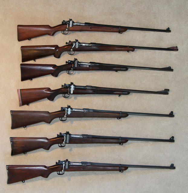

    My Springfields: M2, Sedgley, G&H, G&H, NRA Sporter, NRA Sporter, NRA Sporter.
