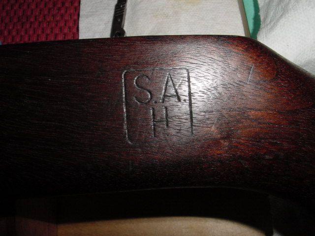

    Strange Stock
    Has anyone seen a stock like this before?

    Looks like a rebuilt ww2 Springfield. Rob 30-06 will know what it is for sure. I believe rebuilt at Springfield by an inspector with an H initial. Rob may want it on his list.

    Quote Originally Posted by SRiverrat11 View Post
    From CMPicon Forums
    chollybob
    02-19-2014, 11:08 PM
    Here is the SA H stock. Again, not in any books or websites.
    Rick Bicon
    02-20-2014, 08:36 AM
    That is a Inspection stamp from rebuild period. It was originally the GHS stamp with two letters ground off. Rick B

    Just an open box post war rebuild inspection stamp. Some were made from earlier stamps by grinding off some of the letters.

    Yes, just a Rebuild with a separate H in the middle. The GHS stamp ground down leaving the H will have a smaller H in the middle like one below. Rick Bicon
