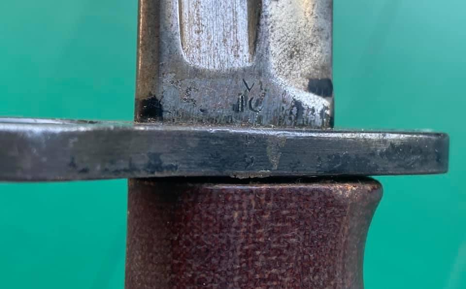

    Current interest is I just bought my second one today. Can't determine manufacturer as markings don't match anything I can find. Is stamped IO in two locations. The first on the base of the blade, the second on the hilt above the sliding mechanism. Also what could be a small P and 9 on the cross guard. It is not one of the rare Wilkenson's I know that for sure. Has paint I'd rather not remove where arsenal marks are known for BSA and Elkington. Trying to describe it accurately on my page and not sure what I should be going with.

    I decided to remove a little paint and found a broad arrow over P on the pivoting portion of the handle. Assuming this is a Poole produced bayonet but it is NOT in a circle which seems odd. Still finding nothing on the IO mark or possibly OI depending which way it was stamped. Broad arrow is lightly struck and the P is not complete although most of it is deeply struck. No indication there is any part of a circle around it. Same with the small P on the cross guard.

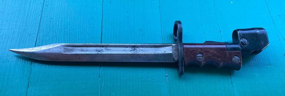

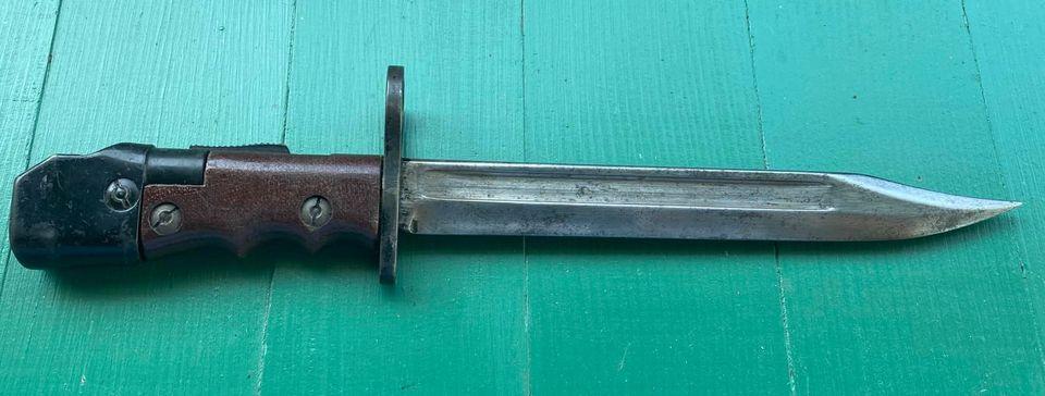

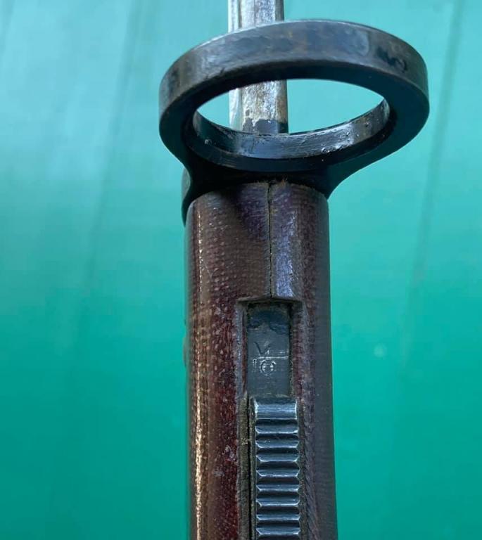

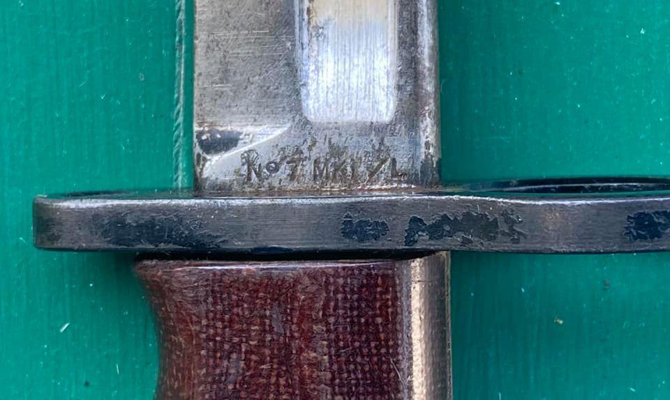

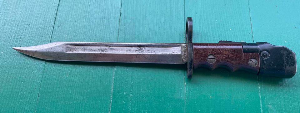

    Here's some photos. I did not take a photo of the broad arrow and P but the two IO's are shown. The P over the 9 is in the third photo.
