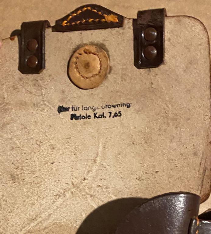

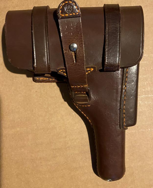

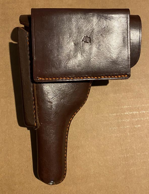

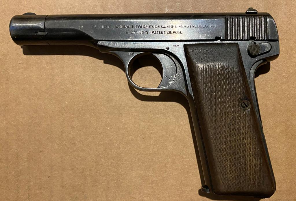

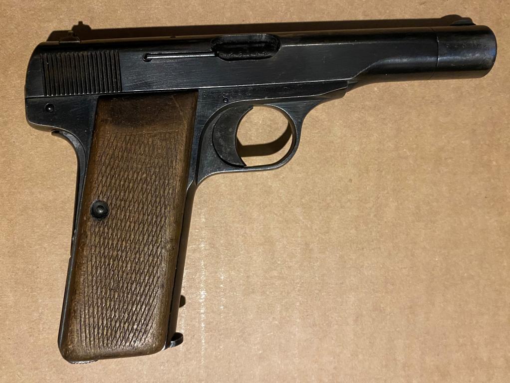

    Browning M1922 was a favorite with the Luftwaffe. Has a cool holster also. Price is sub $1000, Asking price for this one was $600 just pre-pandemic. I managed to get it for $400 with some discounts and special offers they were running at the time. Cabelas purchase. It had sat with them for quite a while and they were willing to discount pretty heavily. They took washed out photos of it which made it look like all the finish was gone They had a second in slightly worse condition but who knows if it's still there, Nebraska store. Holsters can run $300. I scored this one for $150 I think. Unissued.
    Authenticating them to specific use is tough. This one is Germanyicon marked but not military accepted. Means it was a private purchase which is common with officer pistols in all branches. Barrel is marked WaA140.
