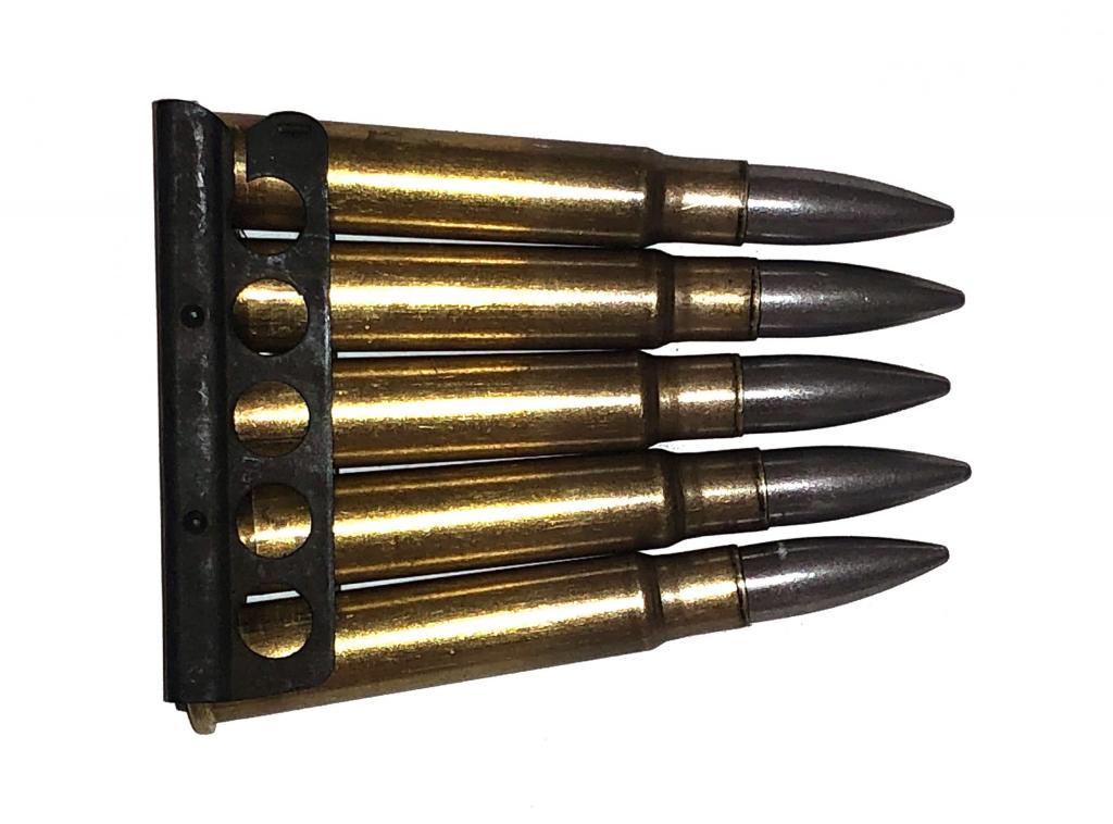

    That sure looks like the classic lumpy fouling left behind by cupro-nickel jackets. Pretty pernicious stuff riflemen struggled to clean until ammo makers switched to gilding metal for jacket material. Those silver looking jackets are the source. Not at all uncommon in ammo produced before the mid Thirties or so.
