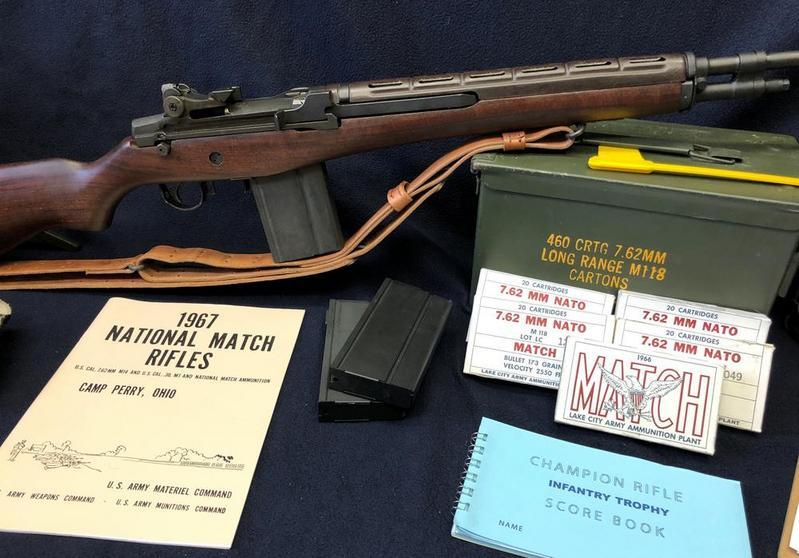

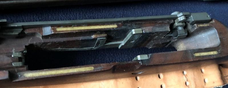

    A few years ago I found a very dry original M14icon NM stock , and had it properly restored for a replica of a 1967 NM M14:
    Original early bedding job, sometimes called "minimal' bedding by collectors
    I might build one more NM replica with a 1969 NM barrel that I have. (so the old stock in this thread is of interest).
